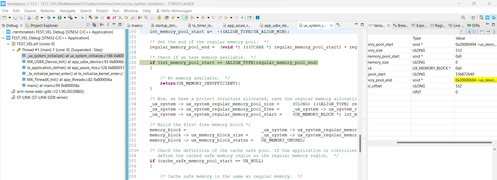

Configured USB_OTG_FS to Device only mode and further configured ThreadX and USBX..
But when running the code it always get stuck at this Memory insufficient error..

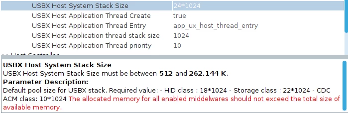

    at which size you set it ?

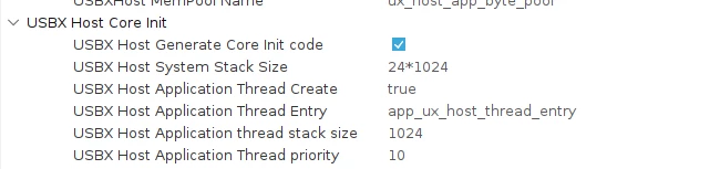

    (for host) i set pool size 0x8000 , stack size 24*1024 B.

    but i see, in your debug pic , pool start - end = 512 B. thats not enough. i have 24KB here.

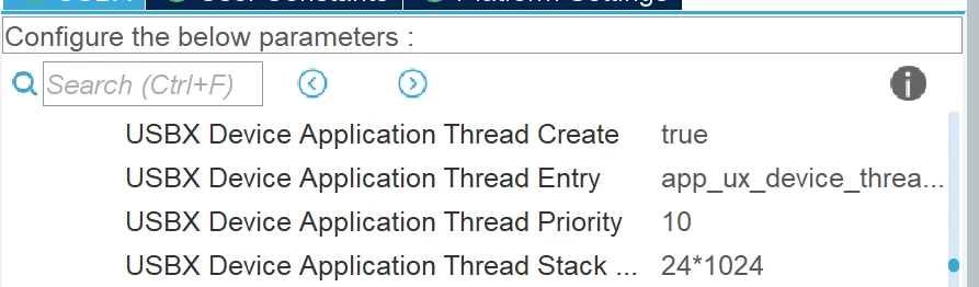

    but you set Application thread stack size also to 24K. try set this at 1024 (as i did).
    and read the info, cube is giving : (we hope, its right...)

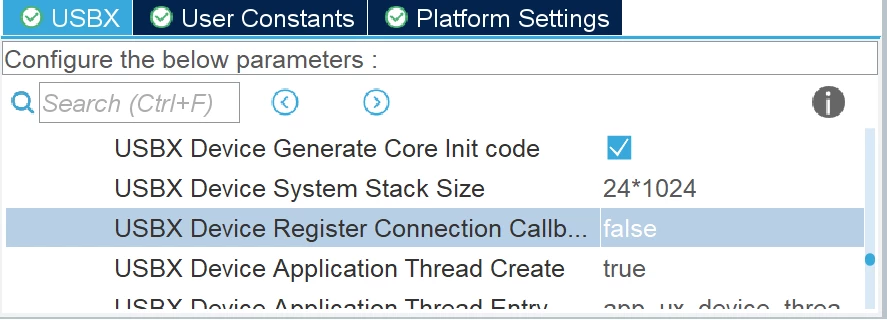

    I changed configuration as follows and it resolved the memory allocation issue. But, the USB is not detected on the device manager on the PC. Not sure if i am missing anything else. Let me know if you have any suggestions. Thanks a lot for your support.

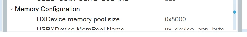

    UXDevice memory pool size = 1024*26
    USBX Device System Stack Size = 1024*22
    USBX Device Application Thread Stack Size = 1024
