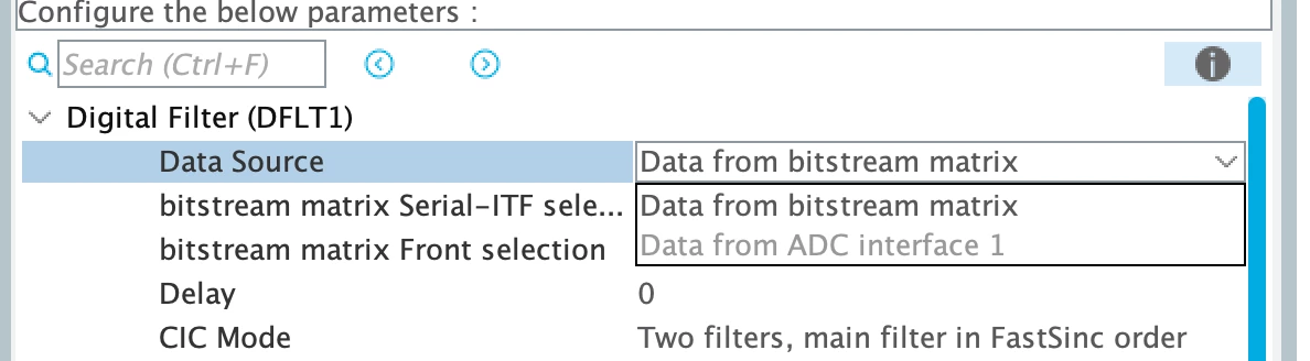

Can anyone give me some hints how can I use ADC1 as data source for the MDF?

Hello @James613 and welcome to the ST Community :smiling_face_with_smiling_eyes:.
I suggest you to put the Cursor on the greyed Command that set the ADC1 as data source for the MDF (as shown on your screenshot). A message will pop-up to indicate how to make this option available or why you can't configure it.

I don't know this function before. I finally found that I need to change the conversion data management mode of ADC1 to MDF mode and the problem solved
