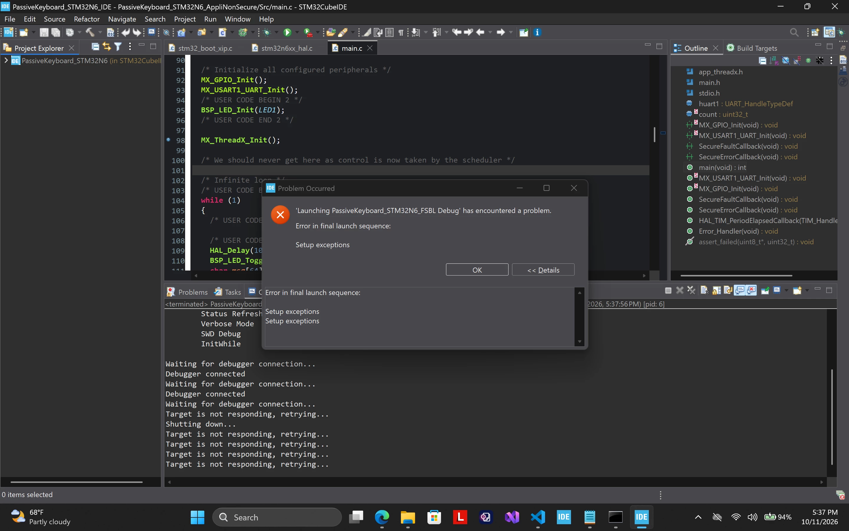

My next step was to add ThreadX, so I configured .ioc to add ThreadX and TIM6 as source clock to SYS_NS, then I forgot to turn on the RTOS awareness to ThreadX->CoreM55 and I begun to fail connecting when hitting debug.

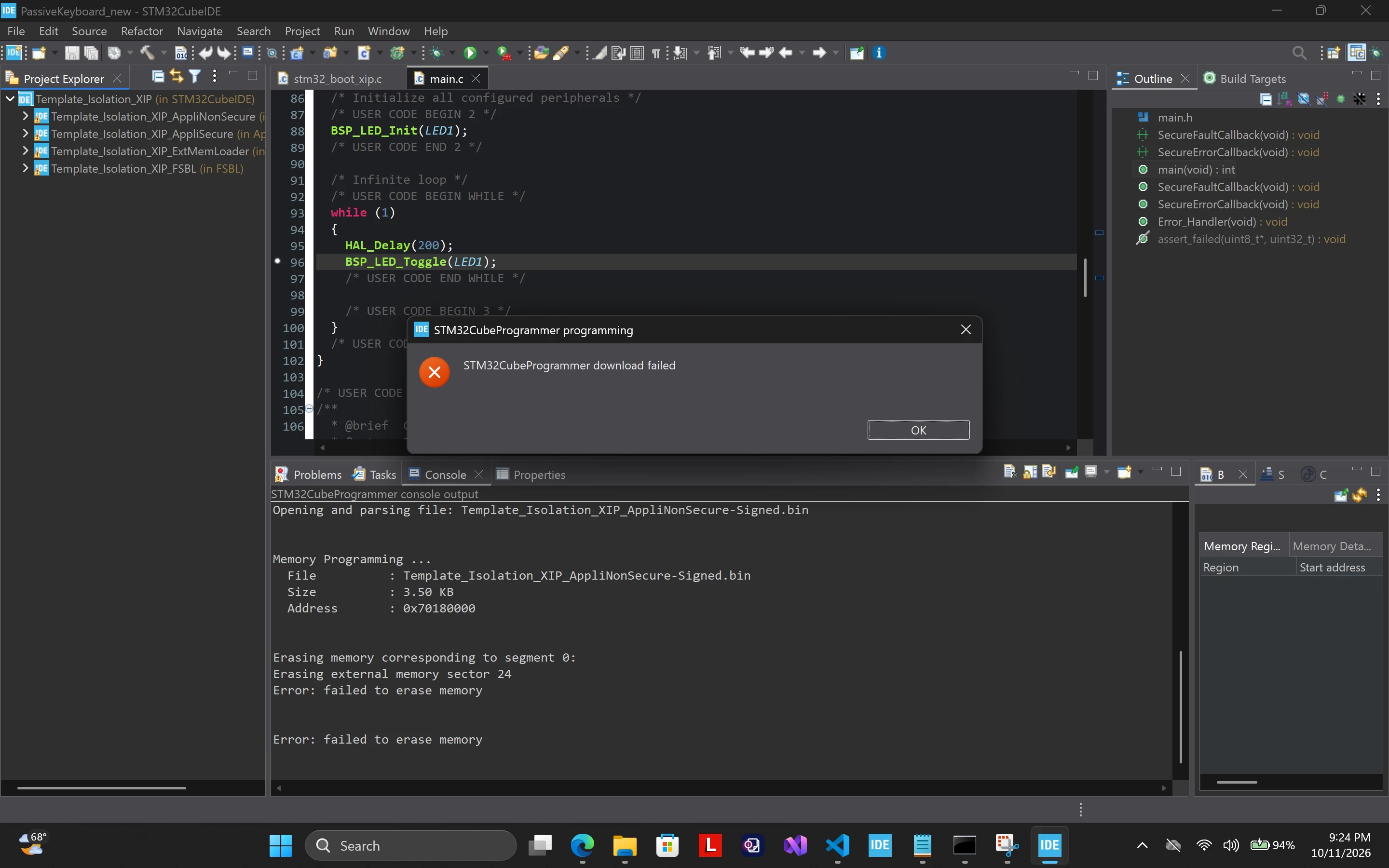

This my screenshot when I first started to encounter the problem:

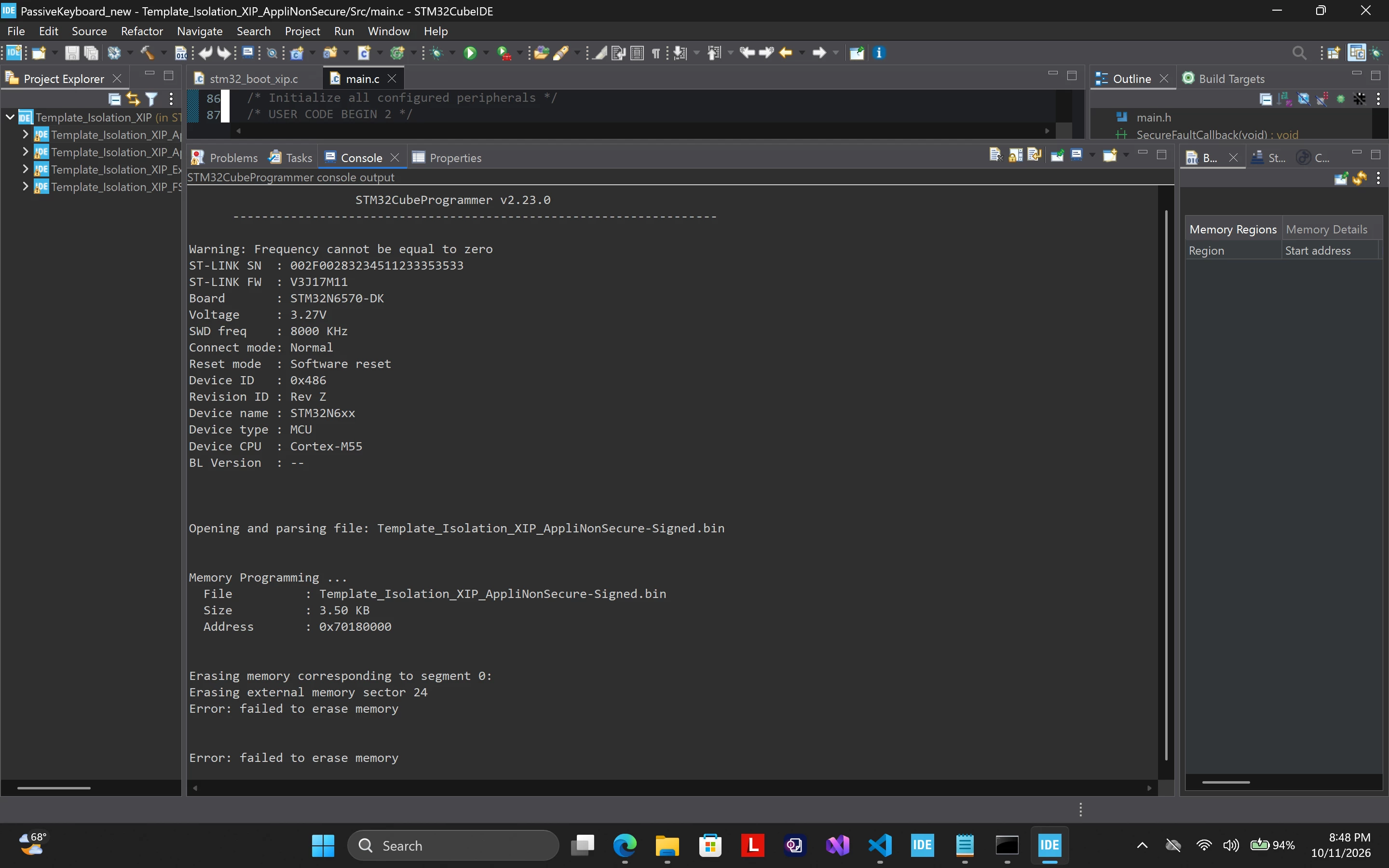

After this, I turn on RTSO awareness and same thing happened, I switch to raw Template_Isolation_XIP working environment, but it is no longer working, althrough out I get this result if i dont use NRST.
During debugging, I tried also to hold NRST and Release after debug, this is happened:
This is the result If I use NRST->Debug

  1. 1. Using STM32Cube Programmer (BOO1 -> H), while external loader is checked, execute Erase External Memory-> Full Chip Erase on → Try Debug on STM32Cube IDE (BOO1 -> L) → FAILED
  2. 2. Check All sectors from Address 0x70000000 then click Erase All sectors → Try Debug on STM32Cube IDE (BOO1 -> L) → FAILED
  3. 3. Tried (1) while nothing is checked in External Loader → Try Debug on STM32Cube IDE (BOO1 -> L) → FAILED
  4. 4. Using STM32Cube Programmer (BOO1 -> H), wrote FSBL(0x70000000), AppS (0x70040000), AppNs(0x70180000) binary each to its designated starting address. → Try Debug on STM32Cube IDE (BOO1 -> L) → FAILED
  5. 5. After (4),in STM32Cube IDE after try debug on default Debug Configuration Setting, I tried to do the following:
    1. a.   Uncheck Halt on exception in Startup Tab
    2. b.  Uncheck All Download for each loaded binary/elf
    3. c.  Reset behavior Type: Connect under reset -> Software System Reset
    4. d. Reset behavior Type: Software System Reset -> None
    5. (All resulted to failed)
  6. 6. from 1 to 4, I tried to disconnect->connect (remove power) the STLink before hitting debug, I tried normal hit debug, and hold NRST → hit debug → release NRST all throughout → all result to FAILED

Fix:
I eventually was able to execute debug with elf (load symbol enabled) for AppNs and AppS by “Removing All Break Points” before hitting debug. Not removing breakpoint even if you left all breakpoint disabled leads to the said issue. The AI said that breakpoints do interfere with XSPI during startup sequence when loading the program from external memory. At this point I can continue with my project.
