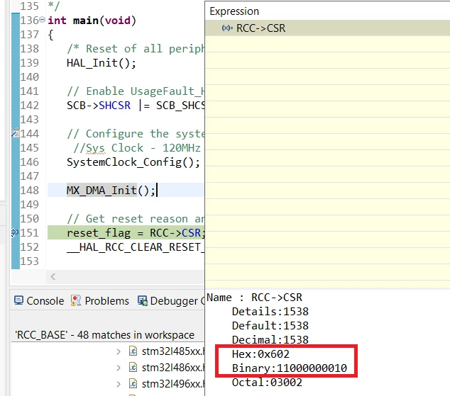

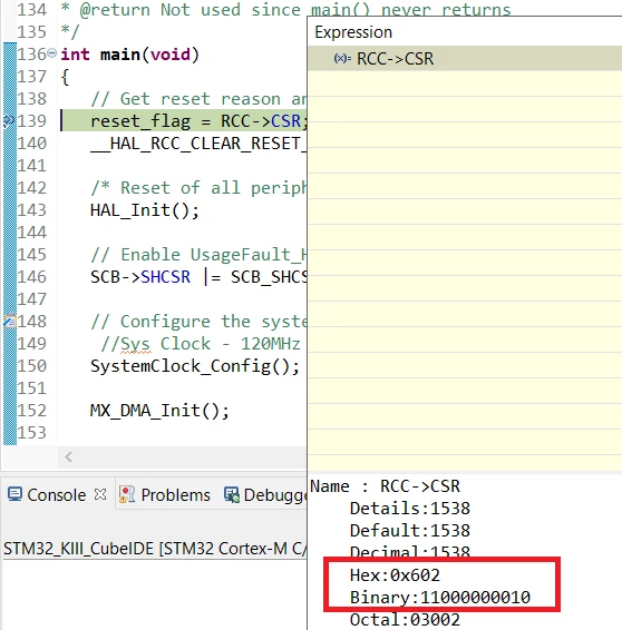

I am seeing really strange behavior where bits 31-24 in the RCC->CSR register are usually always 0. I have verified this behavior on two boards. The only bit I ever see set is PINRSTF but only after programming the board with the debugger attached. Subsequent resets with NVIC_SystemReset(), toggling NRST, watchdog reset, etc do not set the reset bits accordingly.
I have tried reading the registers after basic system init and immediately upon entering main() with the same result. Below are two tests that read RCC->CSR just after calling NVIC_SystemReset().
Test 1 (Read CSR after basic system init):
Test 2 (Read CSR as soon as main() is entered):

I think it just dawned on me. This device uses a bootloader so I imagine the HAL API in said bootloader might be clearing the reset bits. This would explain why they are only set when I program the device because the PC (Program Counter) jumps to the start of the application and the bootloader is not run. That has to be it. I'll update this post once I confirm.
Edit:
My suspicion was correct. The bootloader calls HAL_RCC_DeInit() before jumping to the application.
HAL_StatusTypeDef HAL_RCC_DeInit(void)
 /* Clear all reset flags */
 SET_BIT(RCC->CSR, RCC_CSR_RMVF);
Will update this post with a mitigation when I fin one.

The fix I implemented was to read RCC->CSR at the start of main() and move HAL_RCC_DeInit() from the end of the bootloader to just after reading RCC->CSR.
int main(void)
 // Get reset reason
 reset_flag = RCC->CSR;
 // Reset clock config set by bootloader and clear reset reason bits
 HAL_RCC_DeInit();
 HAL_Init();
 // Configure the system clock
 //Sys Clock - 120MHz
 SystemClock_Config();
 MX_DMA_Init();
@Piranha​ I agree in that some of the HAL API implementation doesn't make sense, but at least it's a start and better than writing registers directly. I'll take whatever help I can get :)

I am updating my fix as the previous one did not work 100% even though the code ran fine.
Fix: Just delete HAL_RCC_DeInit() from the end of the bootloader and allow the application to reconfigure it as necessary.
I originally had moved HAL_RCC_DeInit() from the end of the bootloader to the start of main() in the application as shown above, but this lead to an assert in HAL_InitTick() once I enabled the USE_FULL_ASSERT macro. The code now runs as expected with the macro enabled.
Derek
