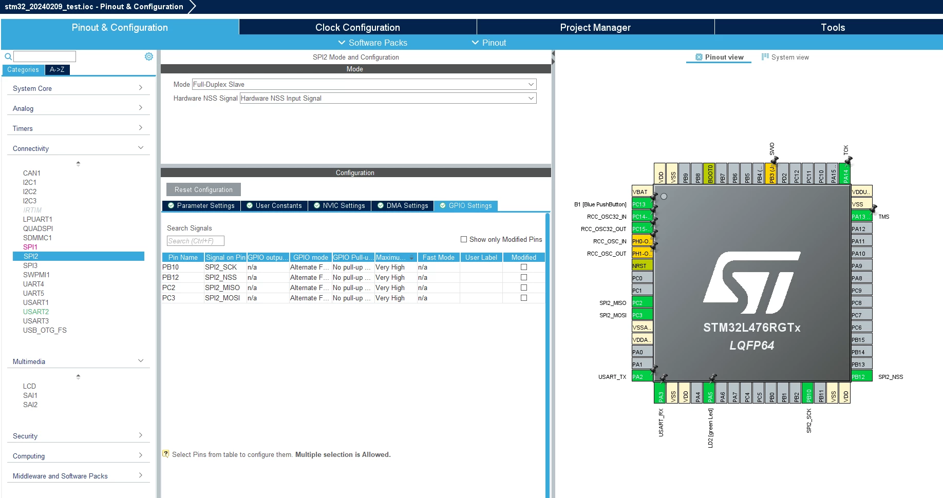

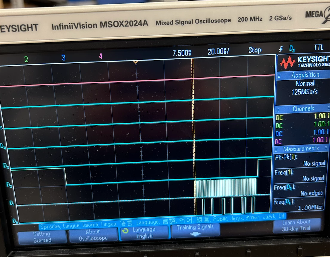

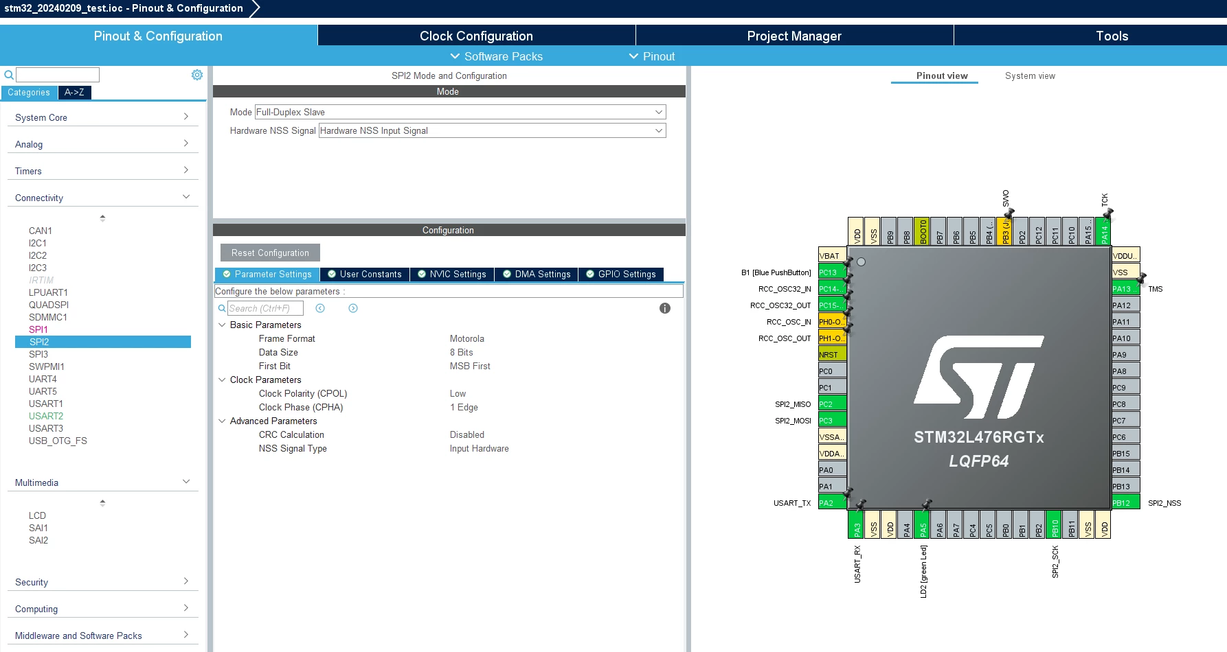

I'm working with an STM32L476RG board and attempting to set it up as a Full-Duplex SPI slave. My configuration in STM32CubeIDE seems correct, but I'm encountering an issue with receiving data. Attached are my STM32CubeIDE configuration screenshots and oscilloscope readings from the SPI master. (Master is sending out 6 bytes, "1, 2, 3, 4, 5, 6)The oscilloscope's D0, D1, and D2 channels are connected to PC3, PB10, and PB12, respectively. I believe my clock parameter settings are accurate.

I've also attached the full code for reference. Any guidance or insights would be greatly appreciated. Thank you in advance for your help!

    Thank you for your reply!
    But shouldn't callback function be called after the receival is complete? I believe that master device is sending 6 bytes continuously(verified by oscilloscope image), so callback function should be called, but it is not being called at all.
