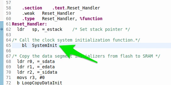

This linker script causes a hardfault immediately (on the second instruction executed), presumably because the stack pointer is bad:
The RAM size in the linker script is by default set to 160K, however, the size of SRAM bank 1 is actually 128K. Changing the map fixes the issue:

I'm not entirely sure why the stack can't be placed in SRAM2 even though it is supposed to be mapped contiguously with SRAM1. This seems to be undocumented in the errata.
