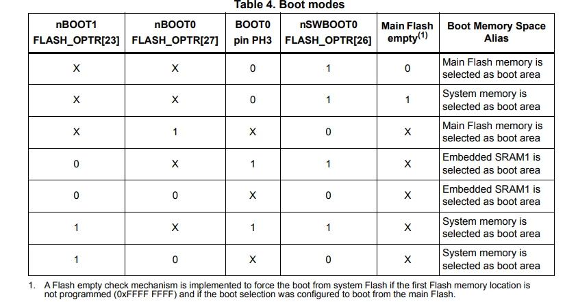

Hi, I'm using an STM32L4P5ZG microcontroller, trying to do a bootloader program. Entering into bootloader mode, exit after a fraction of a second and jump to the main loop. Not staying in the bootloader mode. I tried enabling through software to PH3 pin as pull-high state as well tried the last option by making nBoot1 =1, nBoot0& nSWBoot0=0. Both returned same, not staying in bootloader mode. Whenever I do manually PH3 boot0 pin as pull-high, entering into bootloader mode.

    Your code is a bit of a mess of commented out statements. It should be clear why it doesn't work in its current state as the __set_MSP line is commented out.
    Perhaps take a look at known working code:
    https://community.st.com/t5/stm32-mcus/how-to-jump-to-system-bootloader-from-application-code-on-stm32/ta-p/49424

    That code is known to be a broken bloatware as all of the code from the HAL team. The first comment on that article explains and shows it very clearly!
