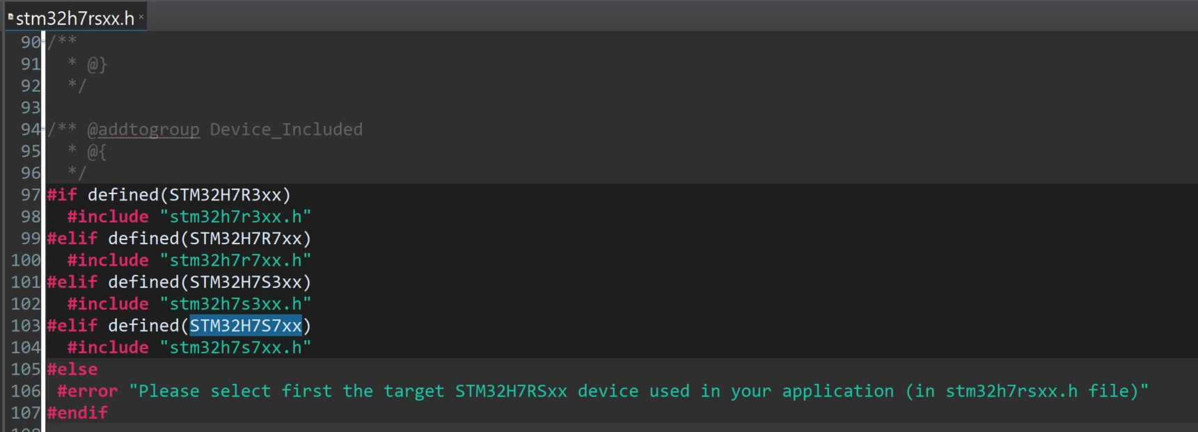

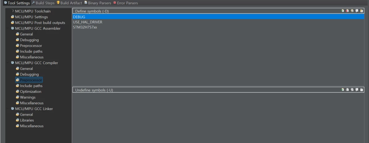

Hello so I am trying LTDC testing with cubeide 2.0 but I cannot use  __HAL_LTDC_LAYER_ENABLE
So there's not defined LTDC and going and going after
I found that STM32H7S7xx symbol is not working
So Is this cubeide 2.0's bug stuffs ?
Or there's anything that I did wrong?

did you start the project using CubeMx ? -> generate code.
Andrew Neil
January 22, 2026
We don't know what you did, so hard to say!
As @AScha.3 asked, did you use CubeMX to create the project and generate the code?
Please describe the exact steps in detail that you made to reach this point.
