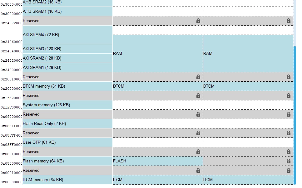

As you probably know, STM32H7S has a very small internal flash at 0x08000000. The 2MB flash should be external, located at other address. Your link script does not specify the external flash but specifies 2MB size for the internal flash. Where have you found this file?
SajidaapAuthor
Sep 14, 2025 7:29 AM UTC
Thanks for clarifying. I now understand that the STM32H7S3L8 internal flash is only 64 KB.
I mistakenly assumed it had 2 MB of internal flash. My project currently links all code at 0x08000000, assuming 2 MB, which is incorrect.
I would like guidance on the best way to proceed with internal flash programming. How can I reduce my Mongoose bootloader + webserver to fit within 64 KB of internal flash?

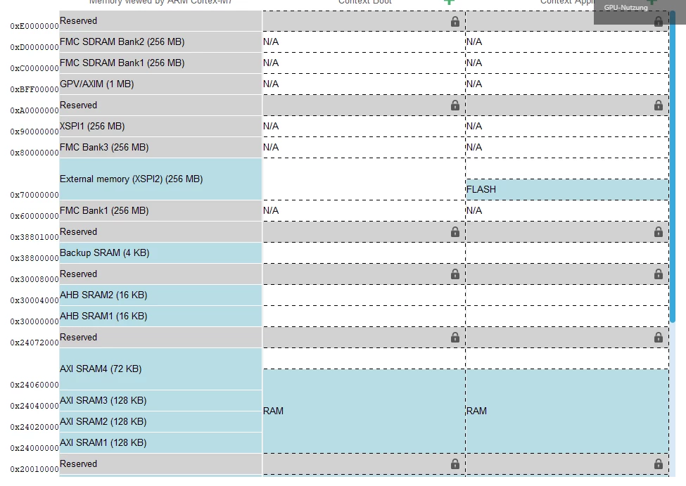

You actually dont. The Nucleo H7S3L8 is designed to work with a bootloader and application, and even though you coul split up the flash into 32KB of flash in context boot and 32KB in context appli, it isnt best practice. What you would want to do is work with the onboard external flash, which has 256MB, each on XSPI1 and XSPI2.
I prefer using XSPI2 for external flash, but you can also use XSPI1.
You will then make a minimalized bootloader( DMA, MPU, CLK, XSPI, GPIO, EXTMEMMANAGER, Cache) and application, which will sit in 0x7000_0000.
You would want something like this:
Depending on your operating voltage, set the HSLV bit in CubeProgrammar, and load the appli.elf into the XSPI via the external_memory_manager. Be aware that you need all subprojects in advanced mode before generating the code.
If you need more help, dont hesitate to ask!

I have flashed the code in the external flash memory. The Mongoose web server is now working properly.
Thanks.
