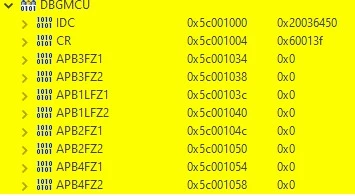

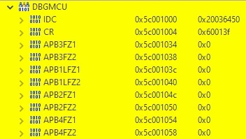

This code works if I just set it to run without debugging, or if I'm debugging CM7. But if I'm connected to CM4 and I step through the first part (around line 7), I will get to the calibration part and that will fail, I have now had the calibration on the background in debug mode for a few minutes. And it is still running the calibration function.
It's like the clock is running real slow or something like that, when calibrating.
My debug registers look like this:
CM4:0693W000005A3abQAC.jpgCM7:0693W000005A3bPQAS.jpgThese should be OK, right? The clocks should be running as normal.
I have now had the calibration running in the background for couple of more minutes, and it is still running, without hitting any timeouts or anything.
I tried pausing the run mode manually (breakpoints don't seem to work anymore in this mode) and it is stuck in this mode:
