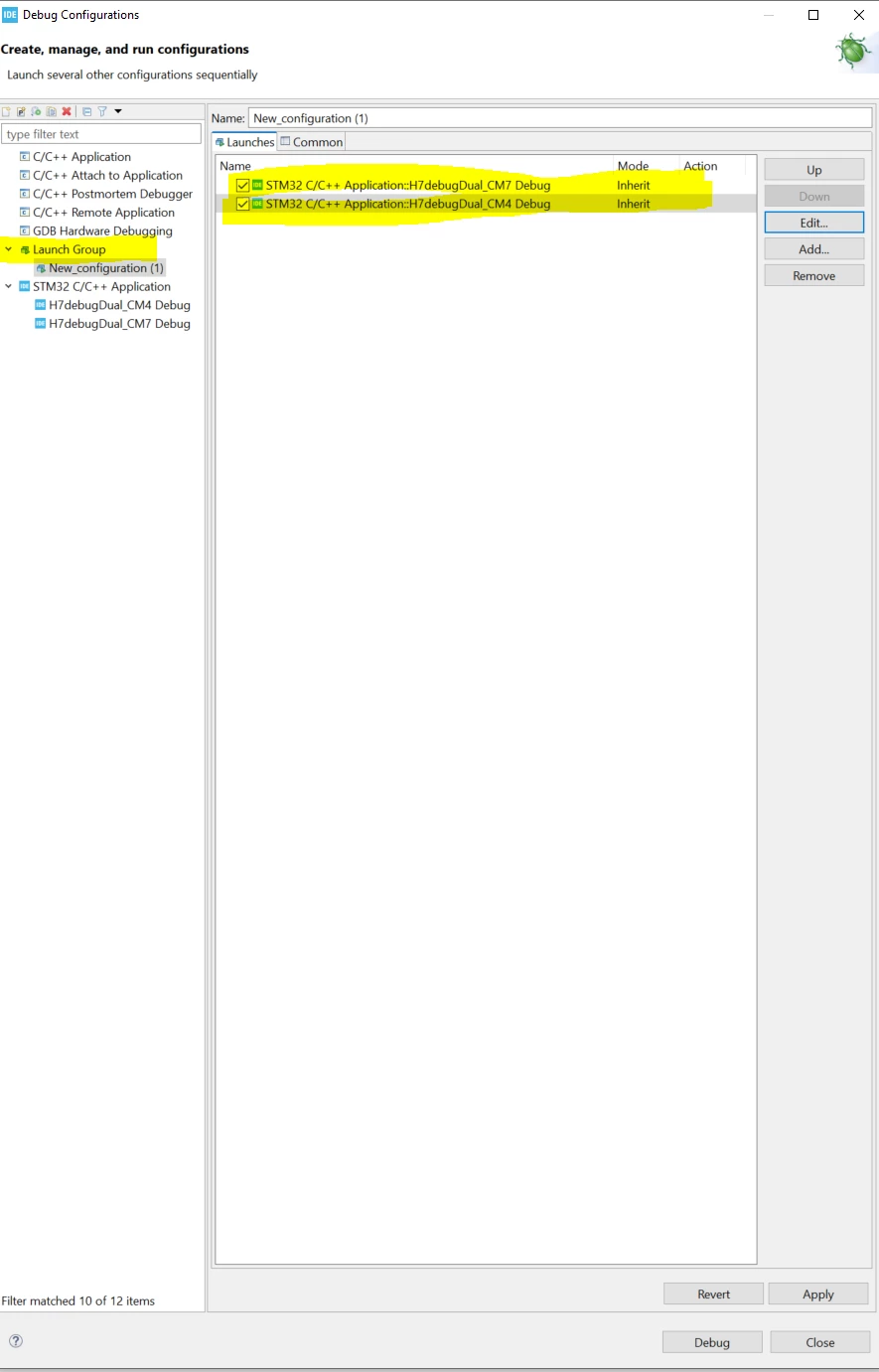

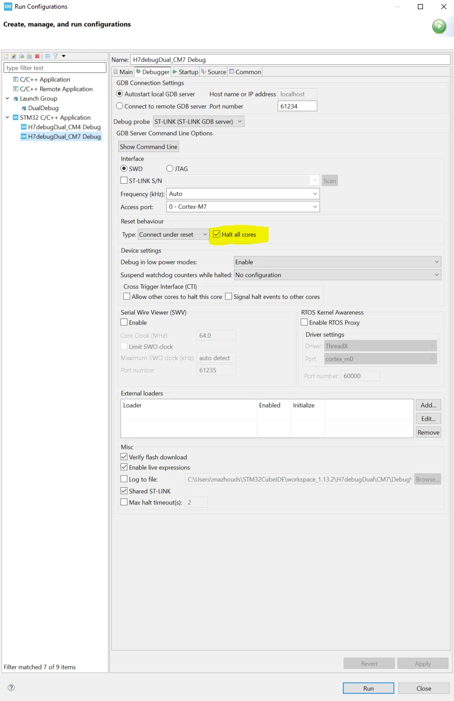

    1-In debug configuration check "Halt all cores" in reset behavior

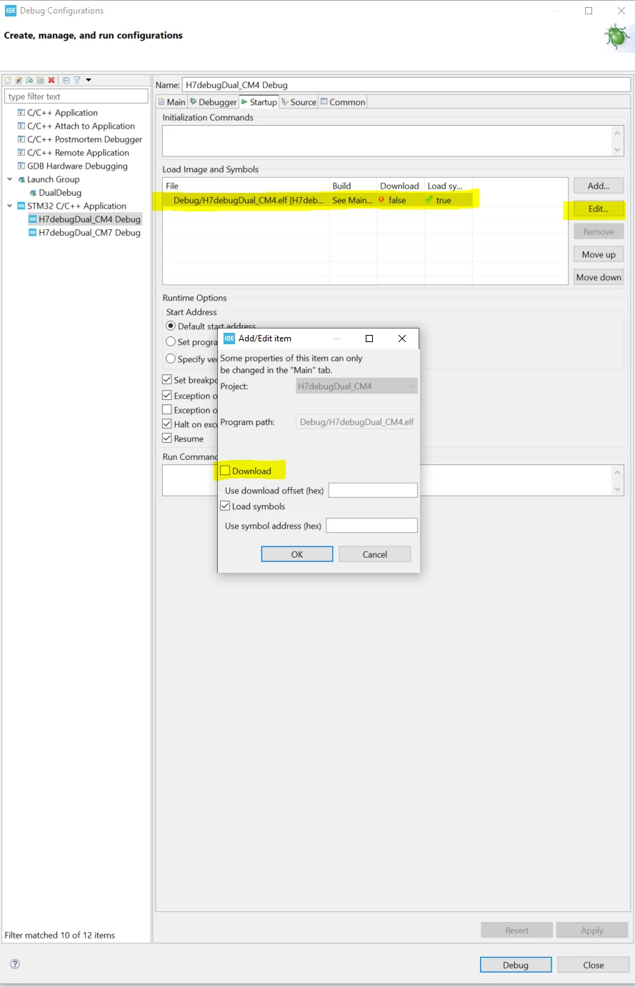

    2-Go to the Startup tab and select [Edit…]>[Disable Download]. This is required since the download is already
    performed by the Cortex®-M7 configuration
    3- You can launch the debug session on both cores with only one launch configuration as shown below

    There are some suggestions in order to troubleshoot your issue :
