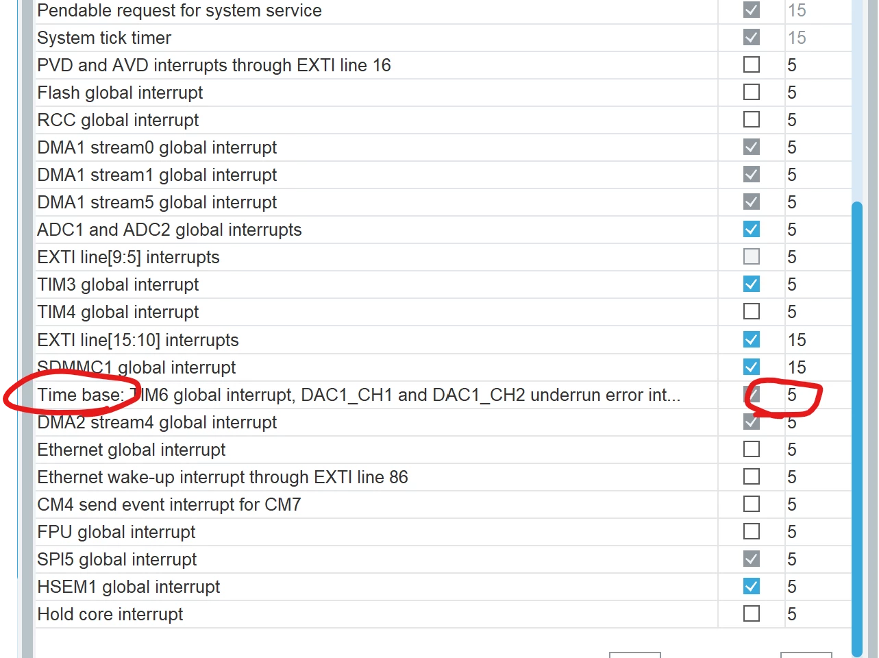

Hi All,
I have a problem on H755 Nucleo which is that the M4's tick doesn't seem to be advancing.
Digging a little deeper I can see that uwTickFreq is zero, but I can't see why that's happened. There must be something wrong in my .ioc file since I've hardly done anything in the M4 code (M7 is working fine).
Currently, both cores boot with FreeRTOS on each. I can step through a simple bit of code on the M4 using osDelay(), however as soon as HAL_Delay() is called that's the end of it.
I have searched this forum and read several Q&A on this topic, but none of them seem to match my situation. I'd be very grateful if anyone can spot an obvious error in my .ioc file.

The tick priority needs to be higher (numerically lower) than the interrupt you're calling HAL_Delay from.
So for you, that means TIM6 and TIM7 interrupts need to be under 5 if you're calling HAL_Delay from another interrupt with priority 5.

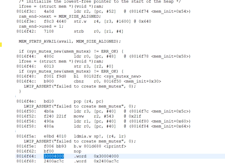

Hi @TDK , ah - good point!  I'm single stepping though, in fact the LEDs aren't enabled on M4, so that's a bit of rotten code, sorry to say.
I think I've confirmed that my ADCs on M7 are trampling over M4's memory though. I saw that uwTickFreq was zero, which was a big clue. So I must have either done something silly in my linker scripts or messed up in the ADC config.

Further update, a look at the CM7.list file reveals where the problem arises:
Clearly the HSEM is using address 0x30004000, which is where CM4 has been told it can start using SRAM1, and CM7 as been told that it can't access any more than 16 kB running between 0x30000000 & 0x30003fff (see the two linker scripts shown in my last update).
Isn't this a bug?
