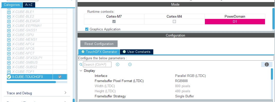

I am trying to use a display lcd using parallel rgb (LTDC RGB888) with STM32h747XIH on a special board.
STM32CUBE-IDE v1.14.0
Touchgfx Designer  v4.22.1
STM32Cube_FW_H7_V1.11.1
My project creation steps are as follows :
1-Stm32 project creation
2-RCC Setting HSE & LSE

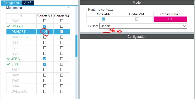

3- I open the LTDC unit and select "Display type RGB888(24 bits)". DSIHOST is automatically checked but DSIHOST Disable is selected.if I try to remove the DSI host tick, CubeIde Message "DSIHOST, LTDC are linked,both configurations will be lost would you like to continue anyway ?" and
4-Middleware and Software Packs -> X-CUBE-TOUCHGFX -> Graphics Aplication checked
5 -Middleware and Software Packs -> FreeRtos -CMSIS_v2
6- Save and generate code
7-Touchgfx->ApplicationTemplate.touchgfx.part duble click and touchgfx designer opening .click Generate code

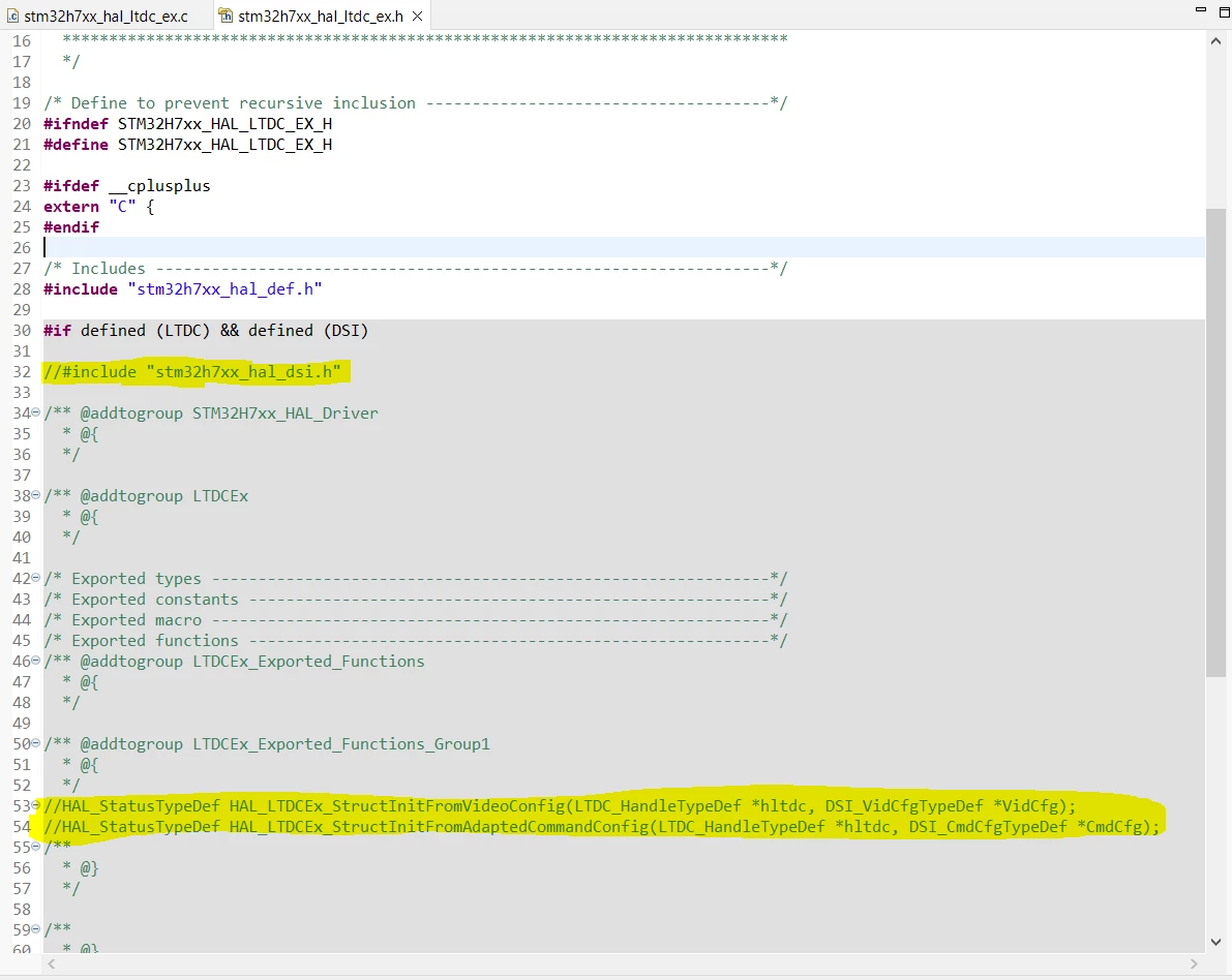

../../Drivers/STM32H7xx_HAL_Driver/Inc/stm32h7xx_hal_ltdc_ex.h:32:10: fatal error: stm32h7xx_hal_dsi.h: No such file or directory

Problem is solved. There is no need to turn off the DSI host. Start the DSI host in "command mode via apb interface"
The solution to the first problem is to create the project completely in cubemx. Uncheck "Generate Under Root" before pressing the generate code button in cubemx.
If I continue with my original question, why can't it find the dsi.h library ? how i fix it ?
Visitor II
April 5, 2024
I've came across the same problem. Disabling DSI mode via "project_name.ioc", "stm32h7xx_hal_dsi.h" file is not included in project workspace but It seems compiler try to execute this line even DSI mode is not active.
Then I realized there is a code   in "stm32h7xx_hal_ltdc_ex.h" file at line 32. "stm32h7xx_hal_ltdc_ex.h" file cannot be reached by stm32cubide workspace but can be manually reached "..\Drivers\STM32H7xx_HAL_Driver\Inc" directory.
I tried to comment out #include "stm32h7xx_hal_dsi.h" line and all function prototypes in "stm32h7xx_hal_ltdc_ex.h" file and build the project "No such file or directory" error no longer exist.
