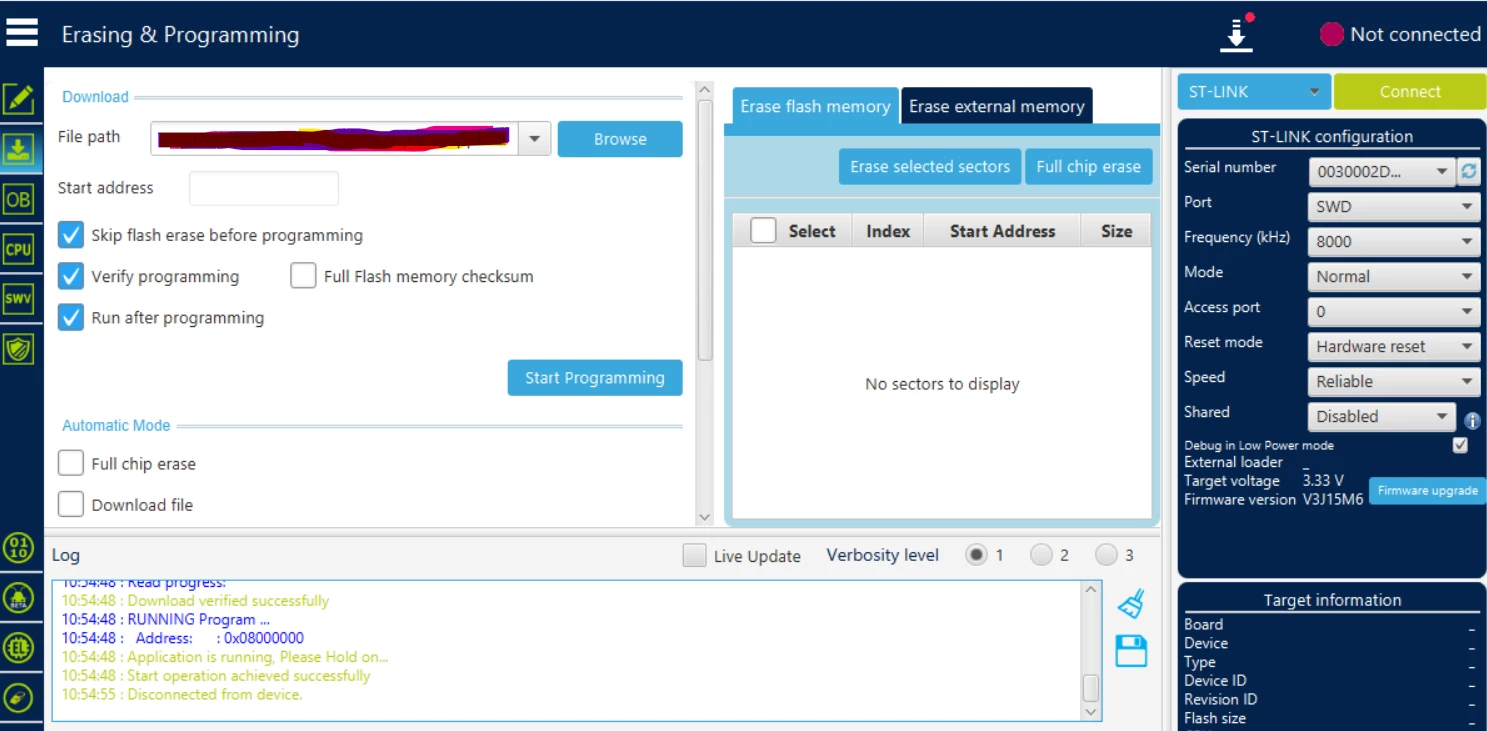

Hi
I need to flash both the cores of stm32h745zit3.  Tried to flash the code using STMCube ide. But after reset pin pressed, cm4 is not getting run. Using ide i run both cores separately. And using programmer tried to load hex separately but it doesn't work. Are there any additional settings required?
Above is the settings used in programmer.
Thanks in advance

How did you know CM4 was not running?
which example and which board are you using?

Second, the issue still not clear. For now forget about your application with ethernet and UART. If you create a simple example and toggle a LED with CM4, do you succeed with it?
Jpj.1
Jpj.1Author
Jan 29, 2025 8:23 AM UTC
No, that too doesn't work.
I made a modification to below function by commenting while(!__HAL_PWR_GET_FLAG(PWR_FLAG_VOSRDY)) {}, but don't understand the impact. now after reset button pressed both cores starts running.
