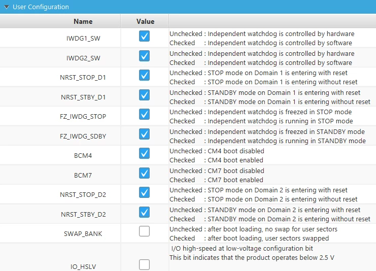

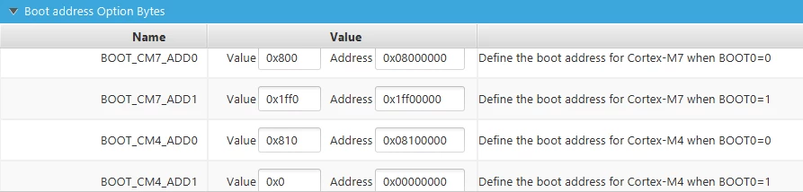

We've double checked the settings according to AN5361 (remember, it worked before anyways).
The option bytes (OB) are as follows according to CubeProgrammer:

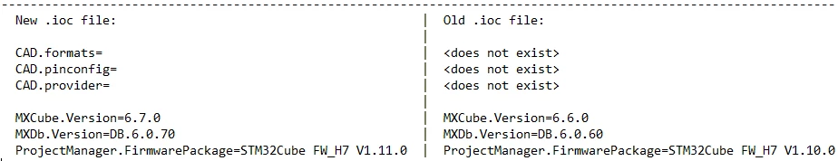

This whole problem started when I initiated the Device Configuration Tool where I was offered to migrate, which I did. CubeIDE then proceeded to downloaded a large chunk of data. I still have CubeIDE 1.10.1 installed but I have not managed to revert back.
The only differences on disk between my original work space and the one created for version 1.11.0 is in the .ioc file:
Apart from that, there's also this new file called .metadata. All other files are identical.

So I dug a bit deeper and managed to return to my previous setup that I can actually run in CubeIDE 1.11.0 but I had to make sure not to migrate to the latest firmware. Apparently there's a whole slew of changes in all sorts of files in HAL and probably elsewhere.
