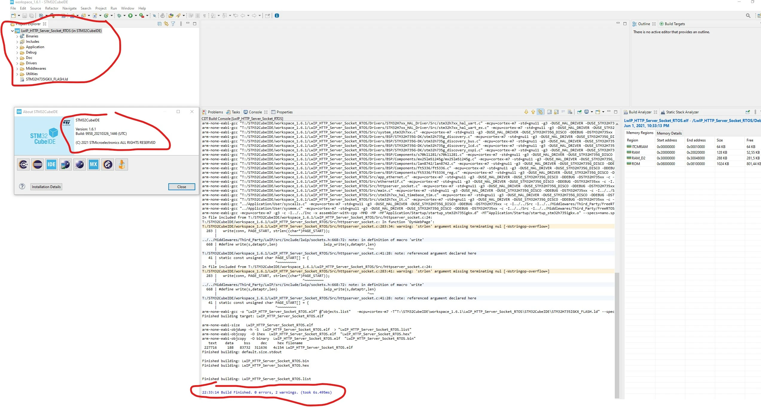

STM32H735G-DK projects and APPLICATIONS ERRORS STMCubeIDE 16.1 LwIP_HTTP_Server_Socket_RTOS - ERRORS ------------ Assertion "REENT malloc succeeded" failed : file "/build/gnu-tools-for-stm32_9-2020-q2-update.20201001-1621/src/newlib/libc/stdlib/rand.
i do not made any modification in code.Is a deliverable from ST.

Works for me ?
What is your workspace path and same about IDE installation repository ? Any special character usage or long path ?
Which OS are you relying on ? (Win10 myself)

I have also the same problem. Is not visible on build log, but only at runtime the code and stdout - this hangs the software at very beginning stage. For my projects is blocking issue. Is there any solution to solve it?

For anyone running into this issue, I'd recommend replacing the _sbrk implementation with the attached file (generated using CubeIDE 1.8.0).
AAlis.23
January 13, 2022
@Markus GIRDLAND​ thanks, works perfect
