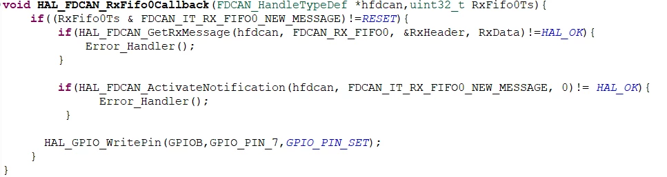

The code seems to be working as I am using some blinking LEDs to monitor the sending and receiving of messages

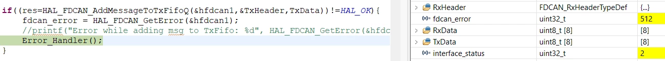

If I try to use Nomal mode instead I keep seeing nothing with the oscilloscope and after a couple of second the LED stops blinking and I get error 512 (the other node is still connected to the bus)

1- Did you have FDCAN Rx interrupt firing?

1- Yes FDCAN Rx interrupt is firing. I connected it with a led to make sure
