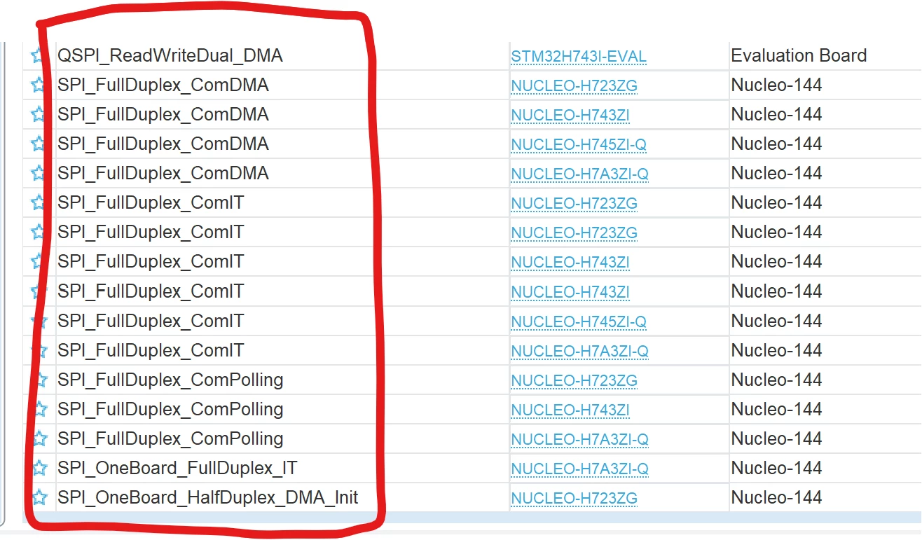

    December 22, 2023
    I would recommend disabling cache and getting started with blocking functions to get familiar with how the chip works. There are several SPI examples in the CubeMX repository, including ones that use DMA. You can use the Example Selector to open them.
