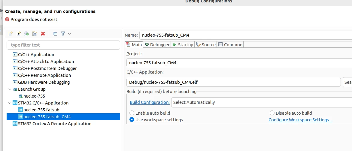

    @Sarra.S, thank you for your answer. My mistake. Now, when you debug with dual core, do you expect to be allowed to proceed by step on both processors?
    To me this don't happen...
    Furthermore, in the video seems that is only necessary to debug configuration dedicated to CM7 (the CM4 is loaded automatically)... If I do the same thing, I see only CM7 side. If I want to see both I need to run the Launch Group configuration. But also in this case the step by step for both processor doesn't works..
    Have you any idea?

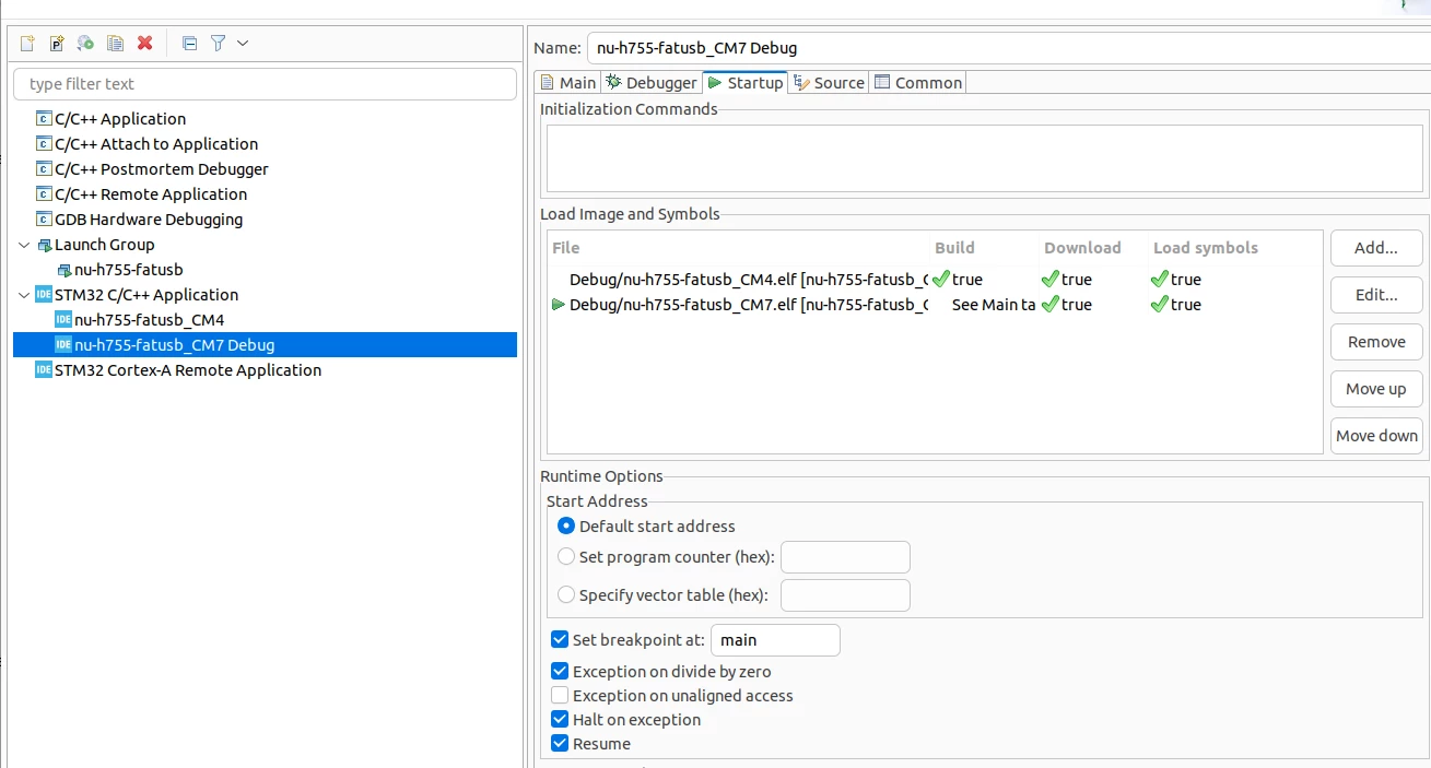

    Hi I am still struggling with similar problems here but one thing that made a huge difference is to not use default break point I assume the standard example will run into misalignment with the power domain wait. so set you break point below this on the M7 core:
     timeout = 0xFFFF;
     while((__HAL_RCC_GET_FLAG(RCC_FLAG_D2CKRDY) != RESET) && (timeout-- > 0));
     if ( timeout < 0 )
     Error_Handler();
    And disable the default break point in Debugging Config / start up. This way the CubeMx proposed start up works and debugging does not mess it up.
    In other works with this tweak the CubeMx example now in version 6.12 frame work 1.11.2 it works together with the process from AN5361 - It seems possible to get it running with default break point but it is way more itchy that way. I assume I have not fully understood what I am doing at this point but to get started this might be helpful trick.
