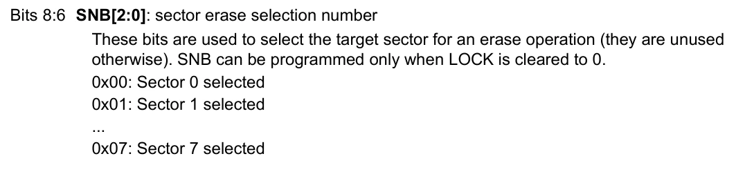

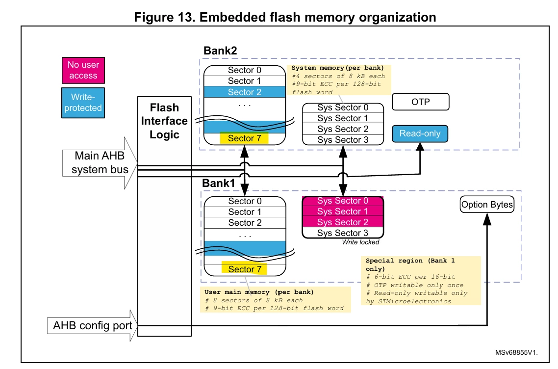

> I could not identify why erasing sectors beyond sector 7 is failing. Please help me identify the root cause and provide a proper solution.
The STM32H503RBT6 only has 8 sectors per bank. You can't erase sectors that don't exist. That is the root cause.
The proper solution would be to restrict yourself to sectors that exist, or move to a chip with more memory if you need it.
Maybe you meant to erase sector 0 of bank 2 rather than "sector 8".

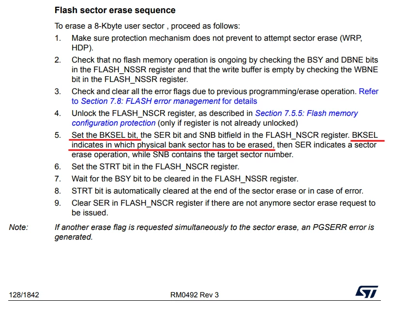

in that case how can i erase bank 2 sector 0.
Jan 7, 2026 2:10 PM UTC
gbm
Jan 7, 2026 8:23 AM UTC
Well, set the bank number to 1 and sector number to 0 in FLASH->CR.

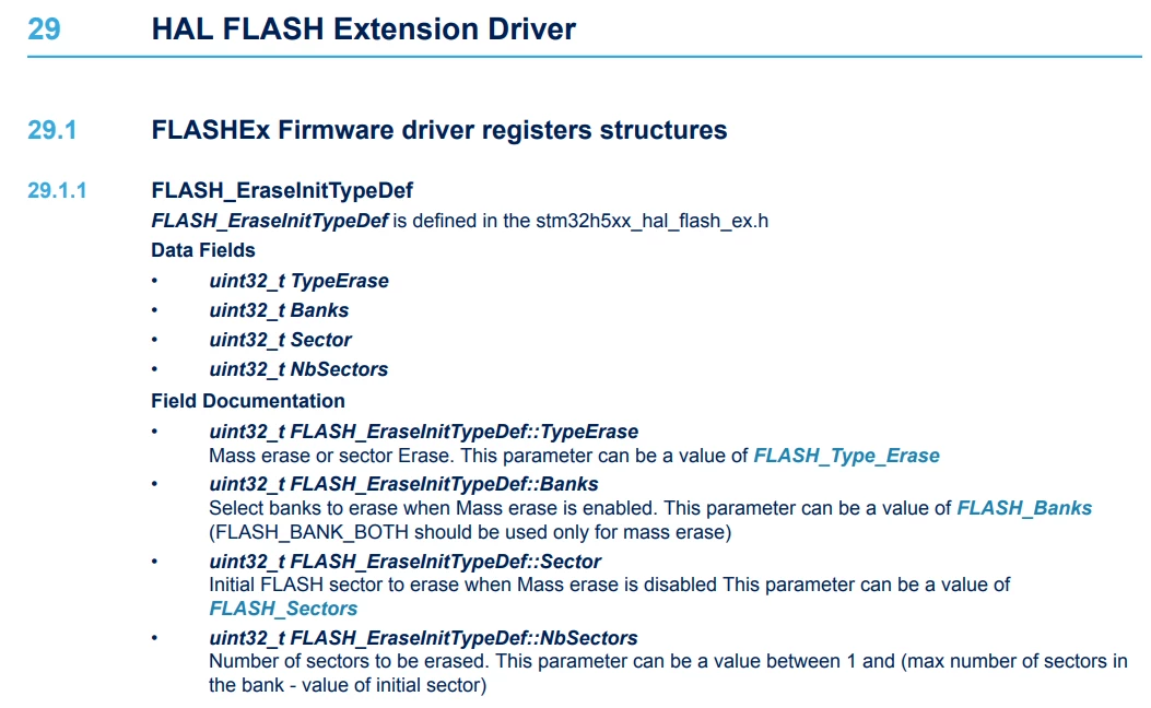

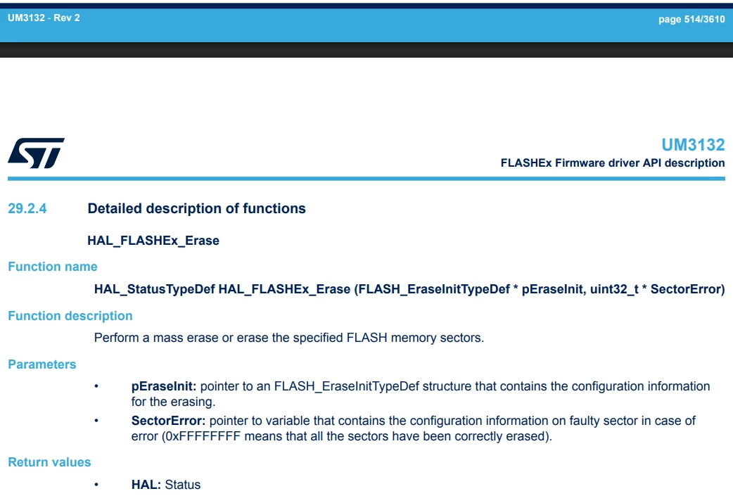

As @TDK said, look at the HAL_FLASHEx_Erase() function:
The FLASH_EraseInitTypeDef structure contains  fields to specify the Sector & Bank:
See: UM3132, Description of STM32H5 HAL and low-layer drivers
via: https://www.st.com/en/embedded-software/stm32cubeh5.html#documentation
via: https://www.st.com/en/microcontrollers-microprocessors/stm32h503rb.html#tools-software
@PRAKKU12 wrote:
how can i erase bank 2 sector 0..
As @gbm suggested, you select the Bank in the Flash configuration register:
https://www.st.com/resource/en/reference_manual/rm0492-stm32h503-line-armbased-32bit-mcus-stmicroelectronics.pdf#page=128
via: https://www.st.com/en/microcontrollers-microprocessors/stm32h503rb.html#documentation
