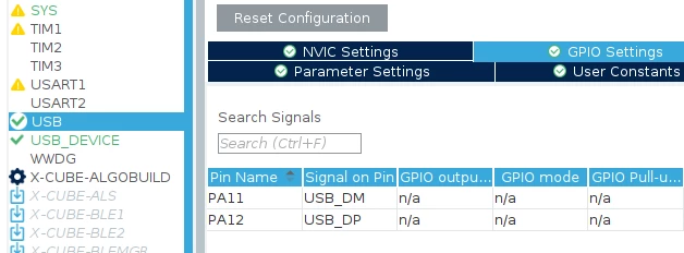

I am currently working on a project involving the STM32G0B1RE microcontroller and had encountered an issue while configuring the USB_DRD_FS (Dual Role Device Full Speed) in Device mode using STM32CubeIDE.
Here are the steps I followed:
  1. I selected the USB_DRD_FS peripheral and set it to Device mode.
  2. I configured the USB_Device in CDC (Communications Device Class) mode under Middleware.
After completing these configurations, I noticed that the GPIO pins associated with the USB_DRD_FS peripheral didn't appear in the generated code or usbd_conf.c

    did you look in usbd_conf.c   for :  HAL_xx_MspInit( ...) ?
    There it should be...

    Am not getting GPIO pins, I get below code inside of PCD_MSP_Init,

    Can you compile the project - or what errors you get ?
    The USB pins can be set up in yet another .c file (msp...) - check all generated .c files.

    Checked in All .c files , couldn't generate  gpio pins of USB

    But you set/enable USB in Cube ? see the pins...and pin settings ?
    (+ debug enabled... ! )
