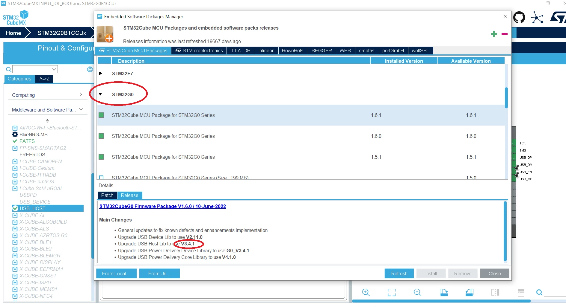

Visitor II
Nov 6, 2023 9:07 AM UTC
Hello, i had a similar problem that was successfully fixed with stm32_mw_usb_host  v3.5.0, but I cannot find the upgrade in STM32CubeMX -> manage embedded sw packages -> SMT32G0.
The last USBhost updated packages that I see is v1.6.1 (USB Host Lib to use V3.4.1); it would be nice to include it in the libraries, so that if I need future project generating codes, could be done.
Thanks!
