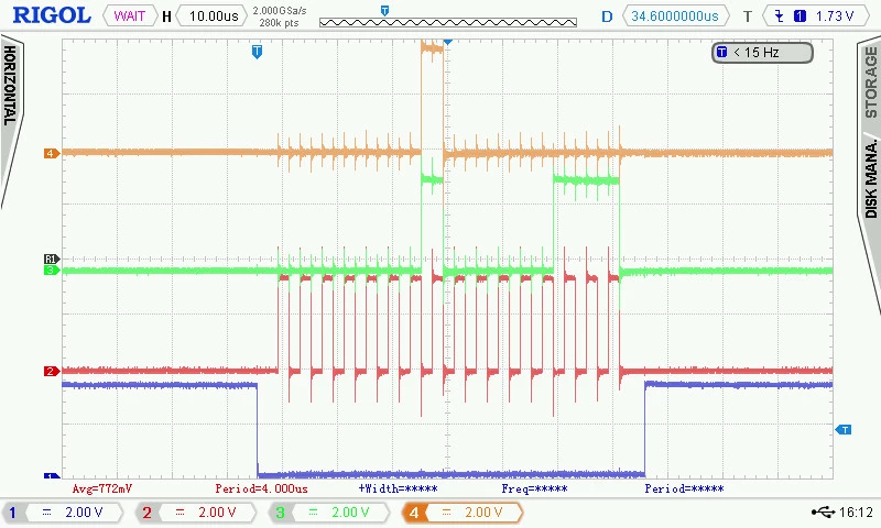

i am using the STM32G031 and the SPI1 port. i have used the SPI port many times on various STM32F devices. I have found some of the STM32G devices have odd behavior. Today i have a strange problem i am running 16 bit SPI1 and when i observe the waveforms i am getting what i expect. However the return value is always 0. despite the waveform showing a value. Waveform attached, yellow CS light Blue clock purple MOSI dark blue MISO
this is my init code, i do not use HAL had too many problems in the past.
I suspect i have overlooked something, most likely obvious, but cannot find it.

    1 reply
    waclawek.jan
    August 30, 2023
    Code looks OK.
    Read out and check/post content of SPI and relevant GPIO registers.
    Check HW (think of bad solder joints and shorts).
