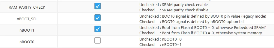

Hi @mattias norlander​ .
You're right, I had already intended to select the best answer, but I think it's better to make a small summary with the answer as well?
We can say that the title "STM32G0 bought with level 2 protection" has nothing to do with the final solution, but I can explain that I thought the MCU has level 2 protection because the STM32 ST-LINK Utility" program is outdated, so using STM32CubeIDEProgrammer was able to connect to the MCU correctly.
After that I tried to debug with STM32CubeIDE, but I couldn't. This was due to the fact that the nBOOT0 entry (in the "user configuration option byte" section) had not been flagged (for your MCU look at the Boot Mode configuration even though almost all MCUs have the same configurations).
The nBOOT0 flag fixed the problem and it was thanks to the advice of @Piranha​ .
I also have to thank @Community member​ , @AScha.3​ and the others (@mattias norlander​ you are included).

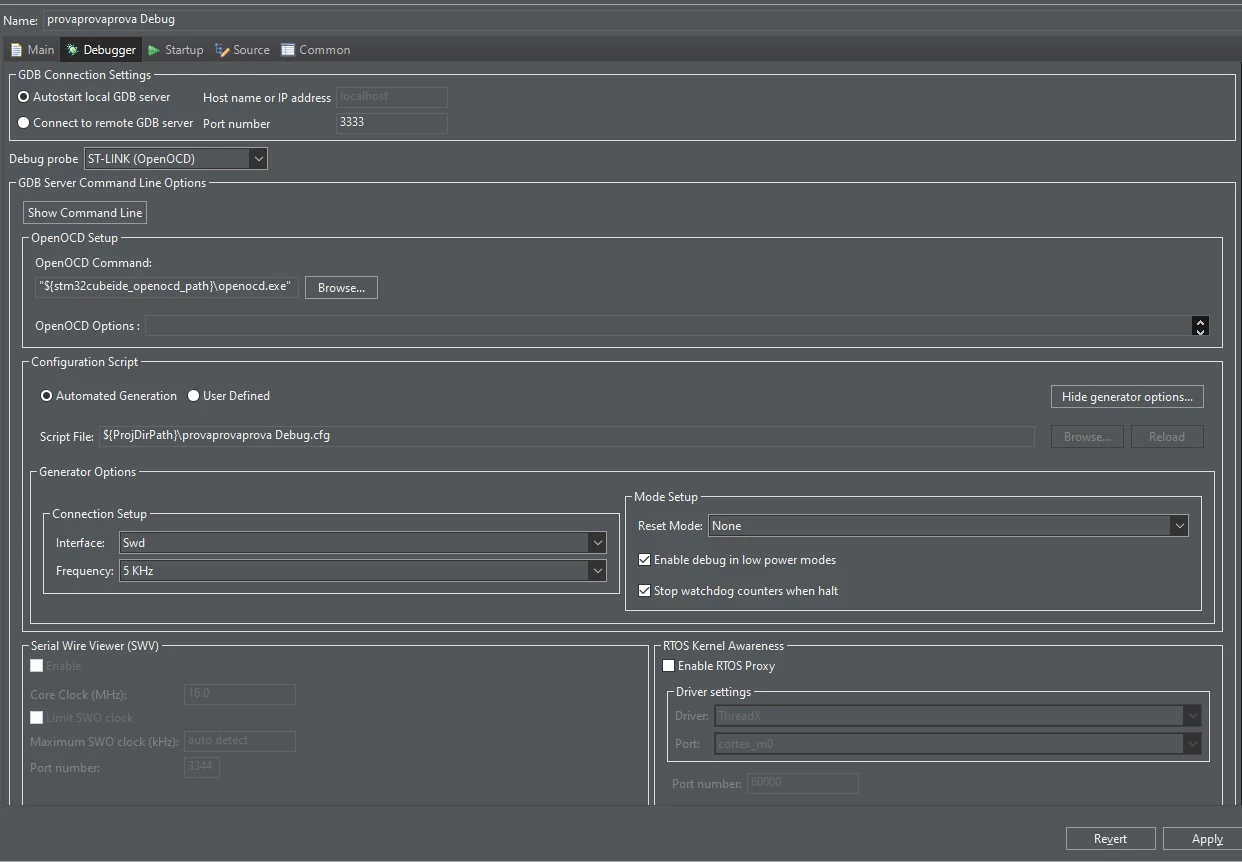

AScha.3
November 29, 2022
good ! so (on this board) all ok, cpu working and connection ok. -> can work with ST...programmer.

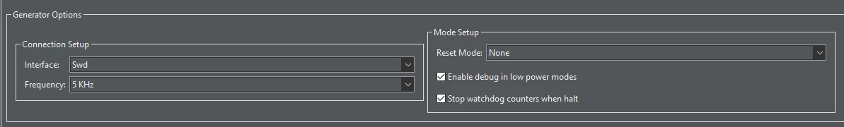

Ide: something you still wrong/bad adjusted.
try: in debug settings: SWD , 4MHz (or lower) ; resetmode: software system reset , + enablew low power ,+ stop watchdog.

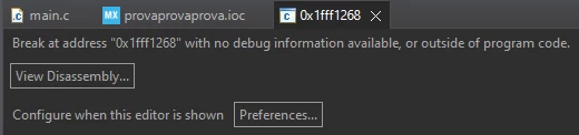

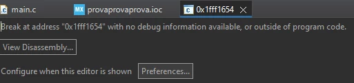

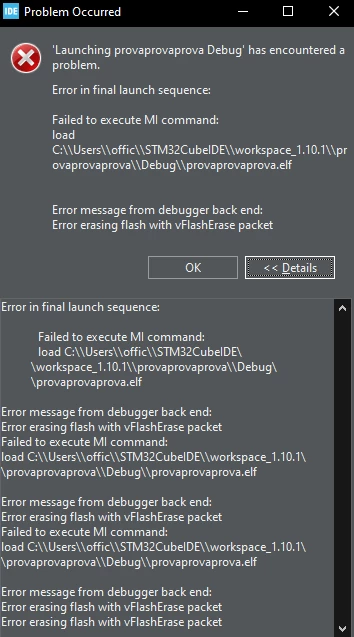

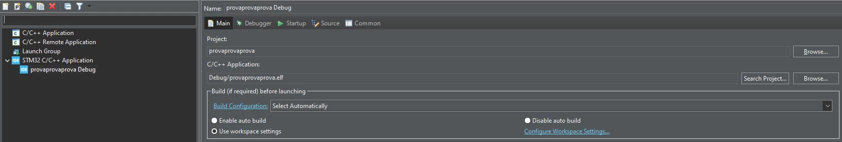

FranzCreva
December 6, 2022

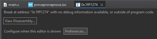

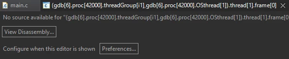

@AScha.3​  and @Community member​ nothing changes!! I've been here for now 2-3 weeks and nothing is working.
The scheduling and degubbing configurations are:
Run configuration
Debug configuration:
If someone could figure out what's wrong with the messages I get on the console it would be a huge favor:
Run messages console

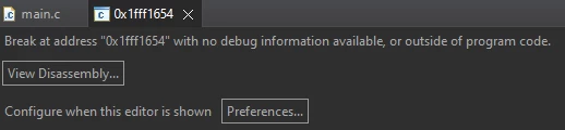

Tesla DeLorean
Guru
December 7, 2022
I don't work for ST, you'll need to raise those responsible for CubeIDE and the integration of assorted components.
The 0x1FFFxxxx addresses are indicative of being in the boot-loader.
Perhaps support for STM32G0 is not where it needs to be, I'll flag this upward.
AScha.3
December 7, 2022
Ooo,
0693W00000WKO9jQAH.pngset:
  • automated
  • 4 MHz
  • software system reset
  • keep pin boot0 lo , at gnd.

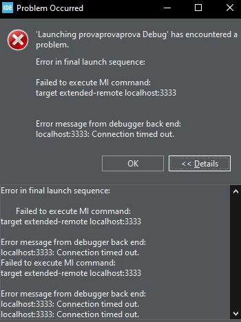

FranzCreva
December 9, 2022
No no, this is not my configuration, I don't know how I managed to take this screenshot.
However my configuration is the same except for the Speed, which I set at 950khz, since with STM32Programmer I can connect to the device with that frequency and not with 4MHz.
If I try to set the speed to 4MHz I get this error:
and this message:

Instead when I try to program it I get the same error as before, but with this message:
Open On-Chip Debugger 0.11.0+dev-00449-g53fa0f7 (2022-06-09-09:42) [https://github.com/STMicroelectronics/OpenOCD]
Licensed under GNU GPL v2
For bug reports, read
	http://openocd.org/doc/doxygen/bugs.html
Info : Listening on port 6666 for tcl connections
Info : Listening on port 4444 for telnet connections
Info : STLINK V2J40S7 (API v2) VID:PID 0483:3748
Info : Target voltage: 3.254557
Error: init mode failed (unable to connect to the target)

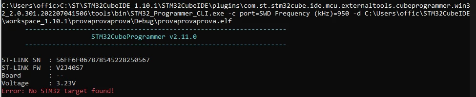

mattias norlander
December 7, 2022

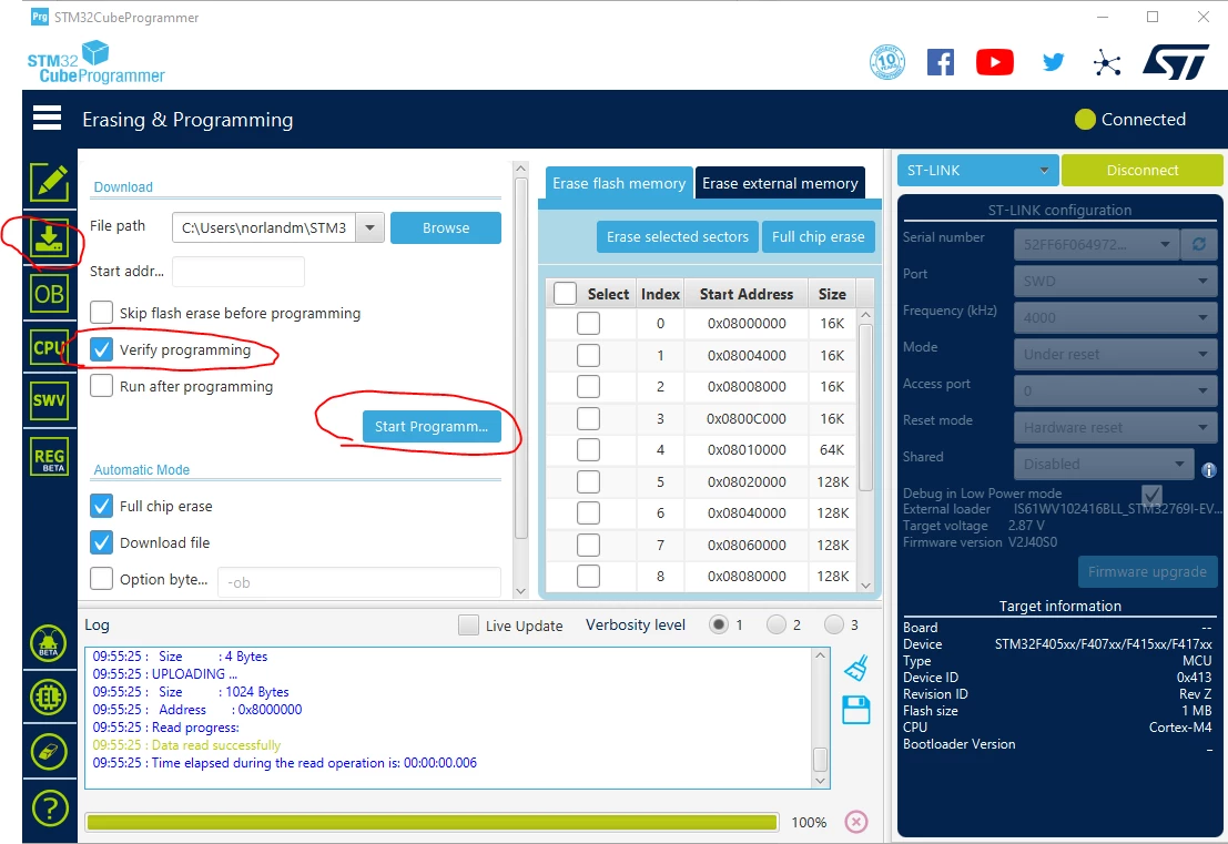

Hi @FranzCreva,
It seems as if you are using CubeIDE version 1.10.1.
In CubeIDE 1.11.0 released last week CubeIDE is slightly better able to detect when CubeProg CLI fails to flash and can abort the debug session a little bit earlier. That said, error handling is still an issue where one root-cause is missing granularity on return codes from CubeProg CLI. And it is unlikely to solve your issues, so no need to update for you.
Question1: Is the application you are developing putting MCU in low-power modes?
If so, you must use:
  • Reset strategy = Connect under reset
  • Enable debug in low-power modes
Not using these options should give you the error shown in the first dialogs: "No device found on target".
Reading this thread it seems as if you are able to use CubeProg stand-alone version in GUI mode to program the device.
Meanwhile inside CubeIDE when IDE is calling CubeProg to do the programming you end up with :
Error: No STM32 target found!
Encountered Error when opening C:\ST\STM32CubeIDE_1.10.1\STM32CubeIDE\plugins\com.st.stm32cube.ide.mcu.externaltools.cubeprogrammer.win32_2.0.301.202207041506\tools\bin\STM32_Programmer_CLI.exe
Error in STM32CubeProgrammer
Shutting down...
Exit.
This makes me curious... I don't have access to a STM32G0... board even less to your custom PCB.
Here is my train of thoughts:
  • CubeProg GUI version flashes the board OK
  • Can CubeProg CLI version flash the board OK?
    • CubeIDE uses CLI version, not GUI version. They rely on same flash loader, but let's make "Test1"
Test1: Try to flash your application relying on CubeProg CLI by using this command:
C:\ST\STM32CubeIDE_1.10.1\STM32CubeIDE\plugins\com.st.stm32cube.ide.mcu.externaltools.cubeprogrammer.win32_2.0.301.202207041506\tools\bin\STM32_Programmer_CLI.exe -c port=SWD -d C:\Users\norlandm\STM32CubeIDE\workspace_IPCEI\STM32F4_RTOS\Debug\STM32F4_RTOS.elf
Obviously you need to modify the two paths in the above example. Does Test1 work well or not?
If not, then we know that the root-cause is isolated to CubeProg CLI ( or potentially the flash loader).
I think this test will be successful. But we have to execute it anyway to narrow down the scope!
Next thought is related to this screenshot of yours:
Here I am thinking that there could be an issue inside the flash loader. If the flash loader does not de-initialize the resources it uses (specifically interrupts) it will leave the MCU in a dirty state.
The effect can be that CubeProg stand-alone can flash the MCU correctly. What you may or may not notice is that the CPU is crashed afterwards depending on how CubeProg applies resets afterwards...
This leads us to Test2:
  1. Use CubeProg stand-alone GUI version to flash your application
  2. Disconnect CubeProg. De-tach and re-attach the board to your PC
  3. In CubeIDE setup a debug configuration which does NOT load the elf-file to target. Use default settings in the debug configuration (use ST-LINK GDB server) and then make these specific settings:
    1. Reset strategy : Connect under reset
    2. Enable low power debug modes (just to be safe)
    3. In the Startup tab > Load Image and Symbols > Debug/myproject.elf > Edit
      1. Disable the Download check-box
With this configuration STM32_Programmer_CLI.exe will not be involved at all. No flashing will be done from the IDE. It assume that the flashing is manually done in step1. All IDE is doing is to reset and connect to the device to just take control of the debug session.
Let us know - what works - what does not work?!
Sorry for the struggle!
Kind regards, Mattias
FranzCreva
December 9, 2022
Hi @mattias norlander​. Yes I use version 1.10.1.
Answer 1:
No, I don't put my microcontroller in rest mode, but I still put the flag, in the debug configuration, on the "Enable Debug in low power mode" item and also "Stop watcdog counter when halt".
I tried to set "connect under reset" as "reset mode", but I got these error messages:

Error executing event gdb-flash-erase-start on target STM32G050F6Px.cpu:
TARGET: STM32G050F6Px.cpu - Not halted
Error: Target not halted
Error: failed erasing sectors 0 to 3
Error: flash_erase returned -304
Info : dropped 'gdb' connection
shutdown command invoked
I tried to do test 1, setting only the port in the first time, then, after seeing that it didn't detect an STM32 device, I also tried to set the frequency, but nothing:
For test 2, following all your directions, it still doesn't go debugging.
The error messages are these:
0693W00000WKbB9QAL.pngand

Hmm... Let me tie back to Test2! Are you saying that CubeProg GUI version could connect to the device and flash the binary successfully??
0693W00000WKdSRQA1.pngPlease confirm. Even please put the CubeProg log information with verbosity level 3?!
It would be very weird if CubeProg GUI work and CubeProg CLI does not work... We need to clarify this first.

Hi Franz,
So you can rely on CubeProg GUI but not CubeProg CLI. You can also not use OpenOCD.
Quite interesting findings.
I need to transfer this discussion internally to see if someone can re-produce it.
For the time being I recommend that you :
  • Use CubeProg GUI to flash the device.
  • Then let CubeIDE (with ST-LINK GDB server) connect to the device without performing the flash loading, just connect and debug. Uncheck the "Download" check-box on the startup tab.

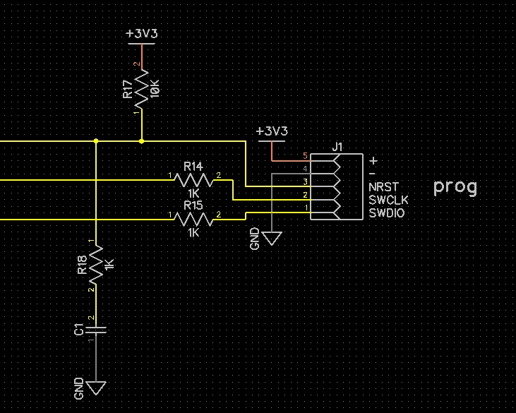

Hi @mattias norlander​ if it can be useful, here is the wiring diagram of how I did the programming part of the MCU:
Since I changed those two 1k resistors of SWDIO and SWDCLK (R14 - R15) I get the error from the previous post.
Did I miss something in the wiring diagram?

R17 should be removed and C1 should be a 100 nF or similar, not 1 uF and such huge values, which are put there to compensate the unnecessary pull-up. Also C1 should be connected directly to NRST and R18, if necessary, should be connected in series between C1 and J1.
Edited by moderation team to adhere to community guidelines

Hi @Piranha​ . Ok.. so by removing R17 I wouldn't have the PCB 3.3V connected to the NRST pin right? Or should I, instead of R17, put a wire to ensure that there is always 3.3V?
Anyway, thanks for the advice, I'll try everything as soon as possible.

you still start booloader...
please show actual option bytes: (this was your setting)
0693W00000Y6uIxQAJ.pngnBoot0 is checked now ??

@AScha.3​ thanks, thanks and thanks again.
I flagged the nBOOT0 and it worked.
