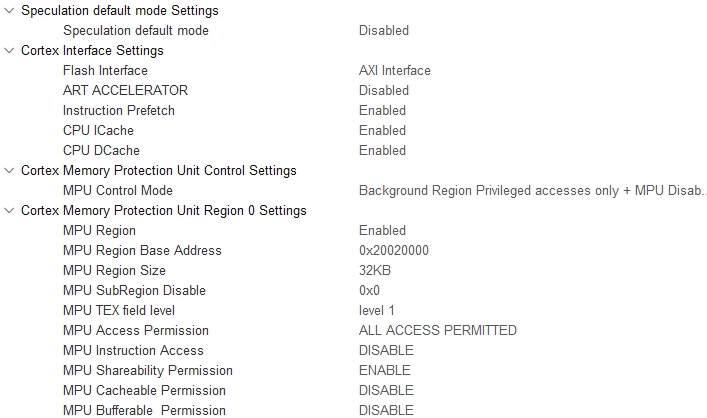

I will use my MCU to acquire big amounts of analog data and transfer them to a host using UDP.

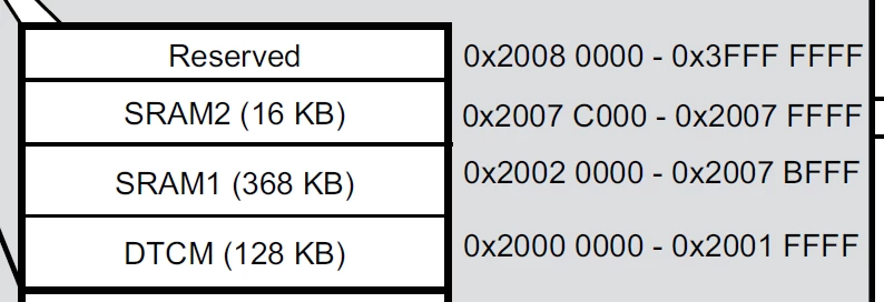

As DTCM is 128K and SRAM1 is 368K I would like to store those data in SRAM1. As an exercice I’m trying to configure LwIP in SRAM1.
I’ve followed many tutorials (MPU is, I beleive, set correctly) :
with a cache protected region where all the LwIP data should be (normally it should only matter when I’ll run this program)

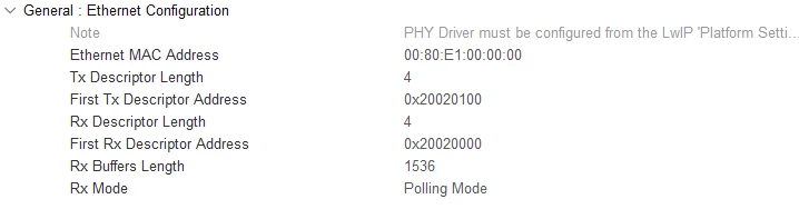

I’ve also configure ETH to point to this area :
And Lwip is also configured with this same area

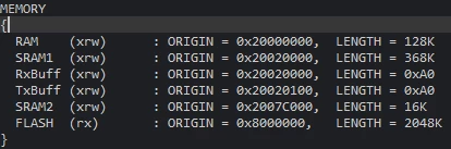

And the flash script is also set :
But when I compile the code directly after importing from cubeMX, I get :
Data are not in SRAM1, they are in the DTCM.
Am I missing something ? Do I have to set some options in the compiler ?
Also I’m a bit surprised to see that 4 descriptors x 32 bits = 0xa0 (0d160) ??? Or F777 descriptors are 40 bits ?

Hello ​@Haarkon and welcome to the ST community,
What is the definition of RAM here:
  } >RAM
What’s the origin defined in the linker file? in the DTCM or in the SRAM1?
For example from this example  this is how it was implemented in the linker file:
MEMORY
FLASH (rx) : ORIGIN = 0x08000000, LENGTH = 2048K
RAM (xrw) : ORIGIN = 0x20000000, LENGTH = 499K
Memory_B1(xrw) : ORIGIN = 0x2007C000, LENGTH = 0xA0
Memory_B2(xrw) : ORIGIN = 0x2007C0A0, LENGTH = 0xA0
Then:
  .ARM.attributes 0 : { *(.ARM.attributes) }
.RxDecripSection (NOLOAD) : { *(.RxDescripSection) } >Memory_B1
.TxDescripSection (NOLOAD) : { *(.DMATxDscrTab_section) } >Memory_B2

The RAM (and FLASH) definition are the one that CubeMX/Cube IDE produce :
It’s OK, as memories DTCM, SRAM1 and SRAM2 are abutting

Jul 22, 2026 3:48 PM UTC
“. = ABSOLUTE(...)” doesn’t do what you want it to. It looks to be a vibe coded suggestion. Creating two linker sections and placing the variables there will work.

Jul 23, 2026 10:11 AM UTC
Thanks for your answers. it works !
