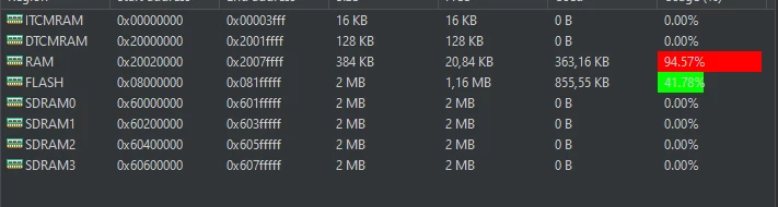

i have enabled D-cache and I-cache and im trying to place static variables into D-cache:
__attribute__((section(".dtcmram"))) __attribute__((aligned(32))) static float32_t FFTOutput_average[MAX_FFT_PRINT_SIZE] = {0};
I updated linker script as follows:
/*RAM (xrw) : ORIGIN = 0x20000000, LENGTH = 512K*/
 ITCMRAM (xrw) : ORIGIN = 0x00000000, LENGTH = 16K
 DTCMRAM (xrw) : ORIGIN = 0x20000000, LENGTH = 128K
 RAM (xrw) : ORIGIN = 0x20020000, LENGTH = 384K
 FLASH (rx) : ORIGIN = 0x08000000, LENGTH = 2048K
 SDRAM0	(rwx)	: ORIGIN = 0x60000000,	LENGTH = 2048K
 SDRAM1	(rwx)	: ORIGIN = 0x60200000,	LENGTH = 2048K
 SDRAM2	(rwx)	: ORIGIN = 0x60400000,	LENGTH = 2048K
 SDRAM3	(rwx)	: ORIGIN = 0x60600000,	LENGTH = 2048K
 .dtcmram (NOLOAD) :
 	. = ALIGN(4);
 *(.dtcmram)
 *(.dtcmram*)
 } >DTCMRAM
 .itcmram :
 	. = ALIGN(4);
 *(.itcmram .itcmram.*)
 } > ITCMRAM
but the linker still places static variable into RAM region. I think the problem is in .bss which is located in RAM section but i dont know how to add it into DTCMRAM.

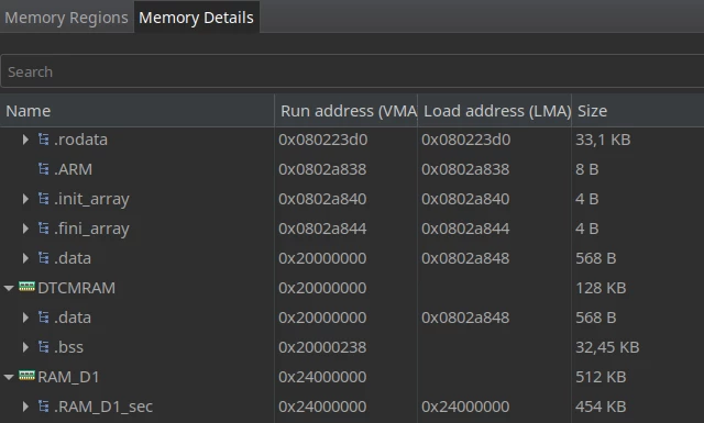

I use (on H7 , similar to F7 ) all :
Try with mod linker script, here from my xxx_flash.ld :
 /* Initialized data sections goes into RAM, load LMA copy after code */
 .data :
 . = ALIGN(4);
 _sdata = .; /* create a global symbol at data start */
 *(.data) /* .data sections */
 *(.data*) /* .data* sections */
 *(.RamFunc) /* .RamFunc sections */
 *(.RamFunc*) /* .RamFunc* sections */
 . = ALIGN(4);
 _edata = .; /* define a global symbol at data end */
 } >DTCMRAM AT> FLASH /* war >RAM_D1 AT> FLASH */
 /* Uninitialized data section */
 . = ALIGN(4);
 .bss :
 /* This is used by the startup in order to initialize the .bss section */
 _sbss = .; /* define a global symbol at bss start */
 __bss_start__ = _sbss;
 *(.bss)
 *(.bss*)
 *(COMMON)
 . = ALIGN(4);
 _ebss = .; /* define a global symbol at bss end */
 __bss_end__ = _ebss;
 } >DTCMRAM				/* war >RAM_D1 */

Yes i have enabled both cashes in *.ioc due to external SDRAM used for LTDC screen buffer. The first bank is used for screen buffer. When i want to access into second bank the STM goes into hard fault handler. The third bank im using for dynamic bitmap(custom graphic). The fourth bank is empty but i need fast access to the variables. So i decided to use space in D-cache.
I edited linker script as you proposed but it is still placed into RAM.

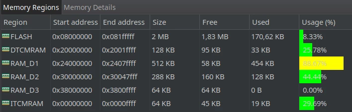

AScha.3
Mar 7, 2025 12:10 PM UTC
You can check in mem.details , where its going to be :
Then you see: is your linker script as you want it - or not.
