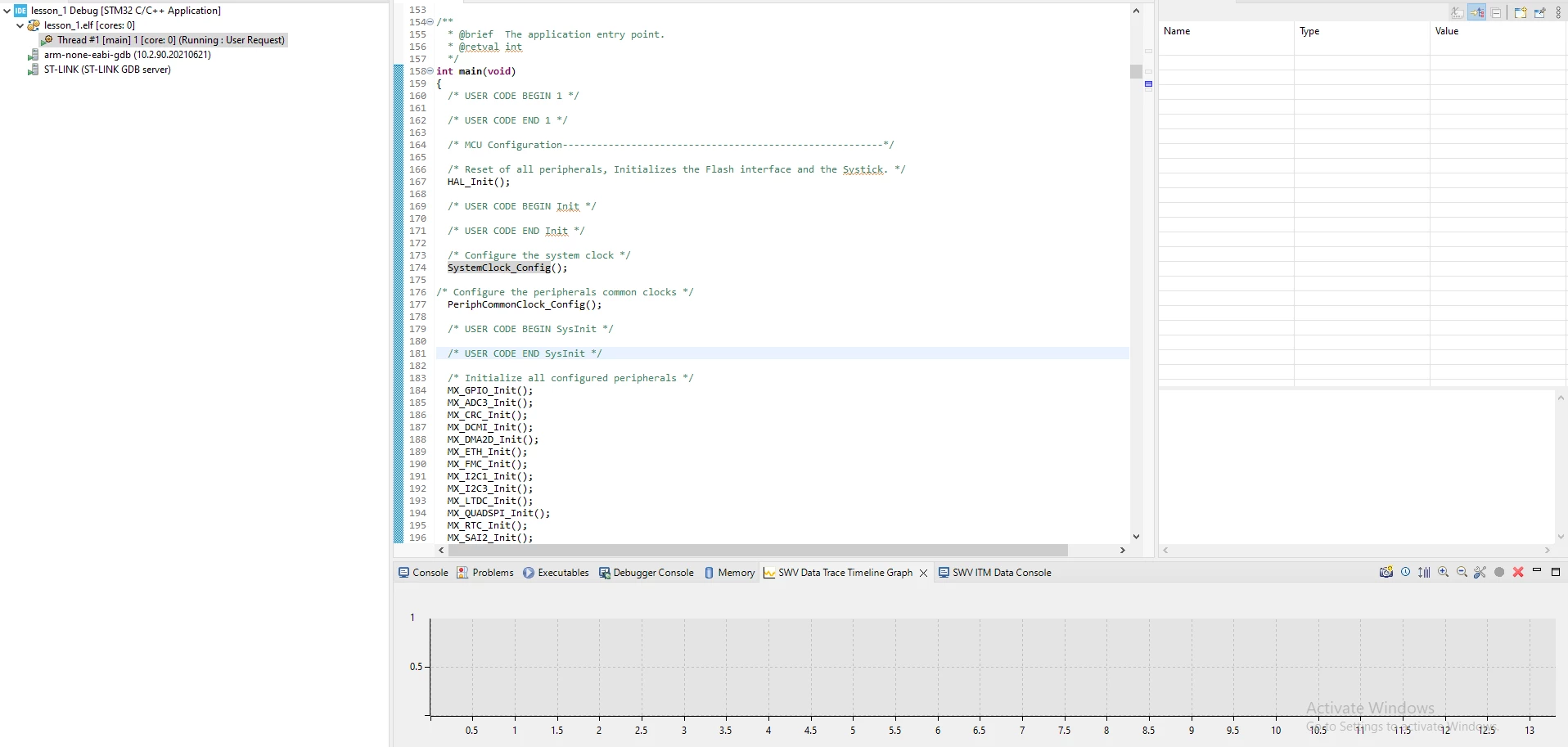

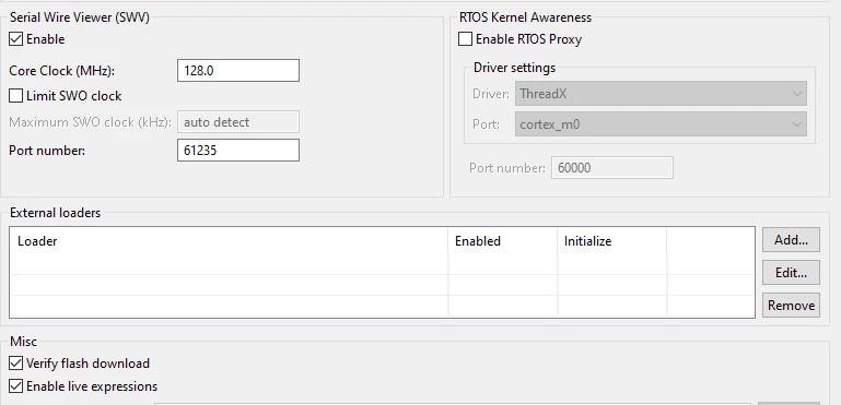

Hello @tempdeltavalue
You can refer to the application note AN4989 debug toolbox section 7.3 Printf via SWO/SWV. If still hanging, Check PeriphCommonClockConfig() to specify the fail.
Hope this helps!
