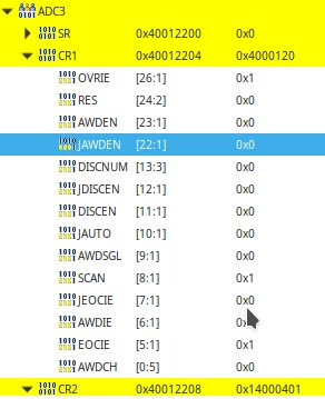

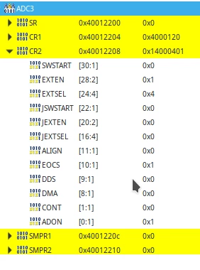

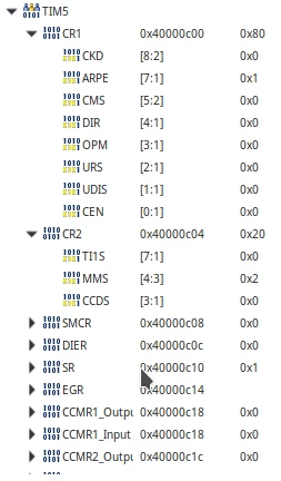

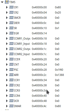

0693W000001cZ2gQAE.png0693W000001cZ2bQAE.png0693W000001cZ2WQAU.png0693W000001cZ2RQAU.pngint main(void)

Know a command for a way to get a text reg dump?
I wish I knew the commands to get the SWD/ST-Link to do a conditional breakpoint on the timer trigger no-output compare bit. It works set for software with HAL_ADC_Start() in the TIM5 interrupt callback. I'm thinking ADC3 must be slaved to ADC1/2? Or some HAL bug? Troubleshooting method - check for clocks, ADON? I've spent hours on this :confounded_face:
Thanks a lot!

TIM5_CR1.CEN=0 i.e. timer does not run.
(It's given away also by the fact that TIM5_CNT does not change).
TIM2_CR2.MMS=0b010 = TRGO from Update appears to be OK as well as ADC3_CR2.EXTSEL=0b0100 = Timer 5 TRGO, and CR2.EXTEN is set, so that looks good too.
You haven't shown the ADC3_SQRx registers, those are important too, determining the channels to be converted and their number. But some conversion should happen even if those are at reset settings, you should see that in status bits (SR.EOC).
I did not look further. Enable the timer; if ADC still won't run, I am out, I don't use the 'F7 and also use ADC rarely.
Read the RM. Seriously.
As you might've gathered, I don't use Cube/HAL and don't understand its gobbledygook. The mcu doesn't use it either, it works out of the registers. You can get many things going directly by manipulating registers in the debugger (watching out for cases where observing in debugger is intrusive, e.g. status bits where reading clears them - shouldn't be the case of basic ADC setup, though, if I am not mistaken - as I've said I rarely use the ADC).
