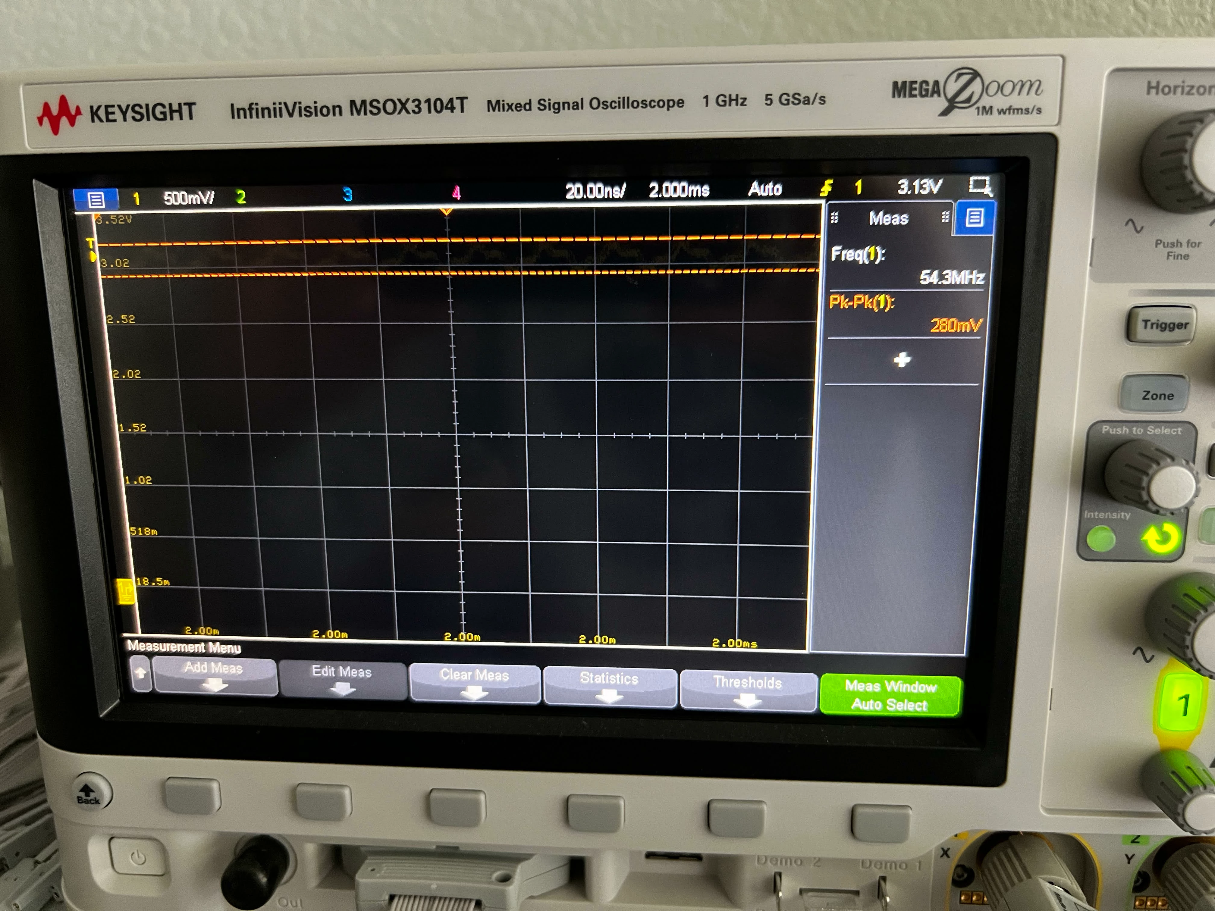

0693W00000KZjziQAD.jpgHere's a scope photo taken from the output of the MCO2 pin (PC9 on the STM32F746). The MCO2 output is set to divide by 4, so the measured frequency of 54 MHz corresponds to a PLL frequency of 216 MHz, which is what is programmed. I see the same MCO2 output frequency when the board is programmed by Atollic or STMCubeIDE.
