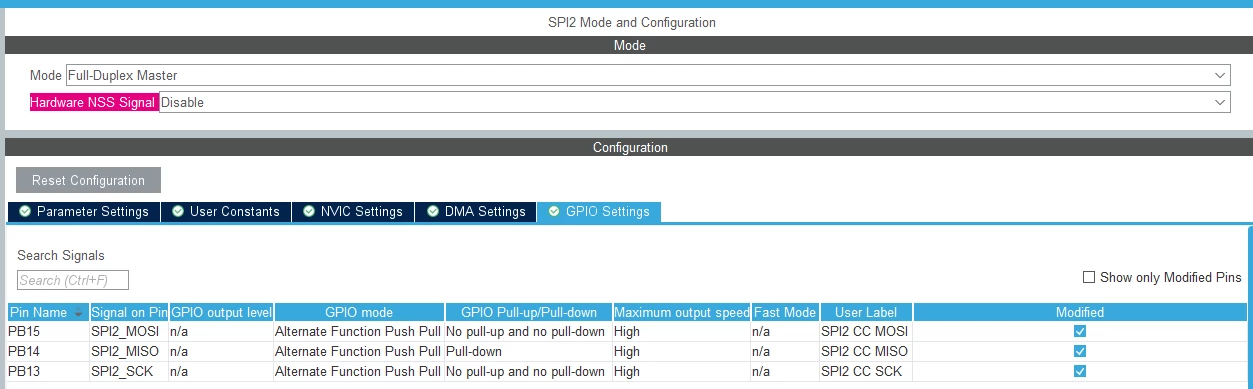

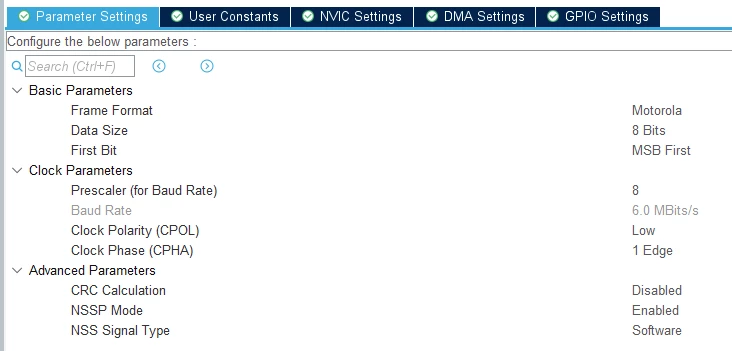

Im currently working on a custom PCB with cc1120 as transceiver and stm32f446RET6 as MCU. I integrate the cc1120 library from IT's library. The device uses SPI as serial communication. Here is the communication example in given datasheet.
With this information i configured the SPI settings as:
after that i use HAL_SPI_TransmitRecieve( ) function as my comm func. in driver. But im not gonna share the complex library instead i will demonstrate the situation. My CS pin and cc1120 reset pin is logic HIGH in idle by software.

In this code first i use command SRES (0x30) for reset the device. In this situation device must be send chip status from MISO line when i start to transmit from MOSI line. But i cant see the chip status byte in MOSI line (Im seeing 0xFF as chip status byte). Chip status byte explained in datasheet as: "When the header byte, data byte, or command strobe is sent on the SPI interface, the chip status byte is sent by the CC112X on the SO pin." and:
Then in while loop , want to access PART NUMBER register for read the chip id. The chip id reg is a extended register (0x2F8F). So first im transmitting 0x2F then 0x8F after that i want to recieve chip id. But again i cant get anything.
So i cant reach the cc1120 device but i don't know why. I tried several different configurations. I use oscilloscope for see the lines and SCK line looks fine to me. Here is the MCU and the RF part of pcb. Almost same as the reference design of the cc1120:

In MISO line im only seeing logic HIGH voltage and nothing else. I think that MOSI line scope results overlapping in while loop but im not sure. How can i solve this problem?

Andrew Neil
April 23, 2024
Are you sure that you have the SPI Mode correct?
Have you asked TI about this - to verify that your design is correct?
For example:
@mrkayaalp wrote:
Almost same as the reference design of the cc1120:?
Is "almost" close enough?
@mrkayaalp wrote:
So there is a external 32MHz oscillator indicated as Y2 but we don't have it so we use 32.578 MHz instead. Is that a problem for the device? ?
You really need to ask TI that question!

Thank you for your response. I swiftly raised the issue on the TI forum and am awaiting their guidance. Confidently, I've configured the SPI settings for Full Duplex Communication, and upon reviewing, the clock configurations appear to be in order.

It seems that the CC1120's SPI is identical to CC1125 - both defined in SWRU295 CC112x/CC1175 Low-Power High Performance Sub-1 GHz RF Transceivers/Transmitter User's Guide.
so here's my working SPI config for STM32F0-Disco to CC1125:
mrkayaalp
mrkayaalpAuthor
April 24, 2024
My settings are same as yours. Which library are you using for the device?
