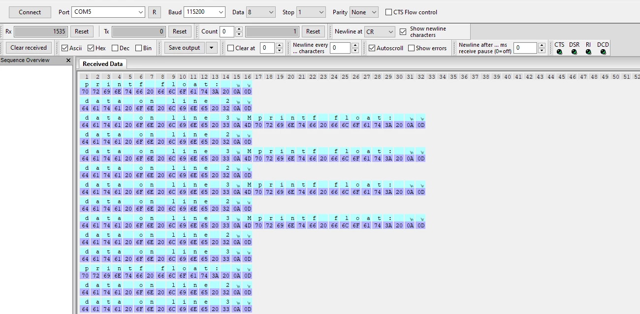

Here's my code:
int main(void)
	float tmp_flt = 1.543;

Terminal view is as follows:
Kindly go through it, anything else you need just tell me.
Waiting for your valuable input.
waclawek.jan
November 21, 2019
Very interesting - almost completely repeatable, and much of the characters gets through unaffected, that's remarkable.
I'd say, there's some slight baudrate mismatch involved. I know you are using HSE/crystal and the baudrate is not that high compared to system clock, so the mismatch should be relatively low; but what's on the receiving side? Is it some USB-to-UART converter? Can't that be mismatched? Can you try a different one (different make, different chip)? Or, even better, can you locate a PC with an onboard UART? Can you try to transmit on it and measure precisely enough the bit duration (you need to get to some 1% resolution at least)? Is there some level conversion involved (RS232)?

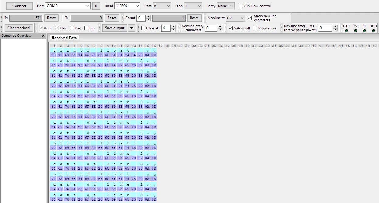

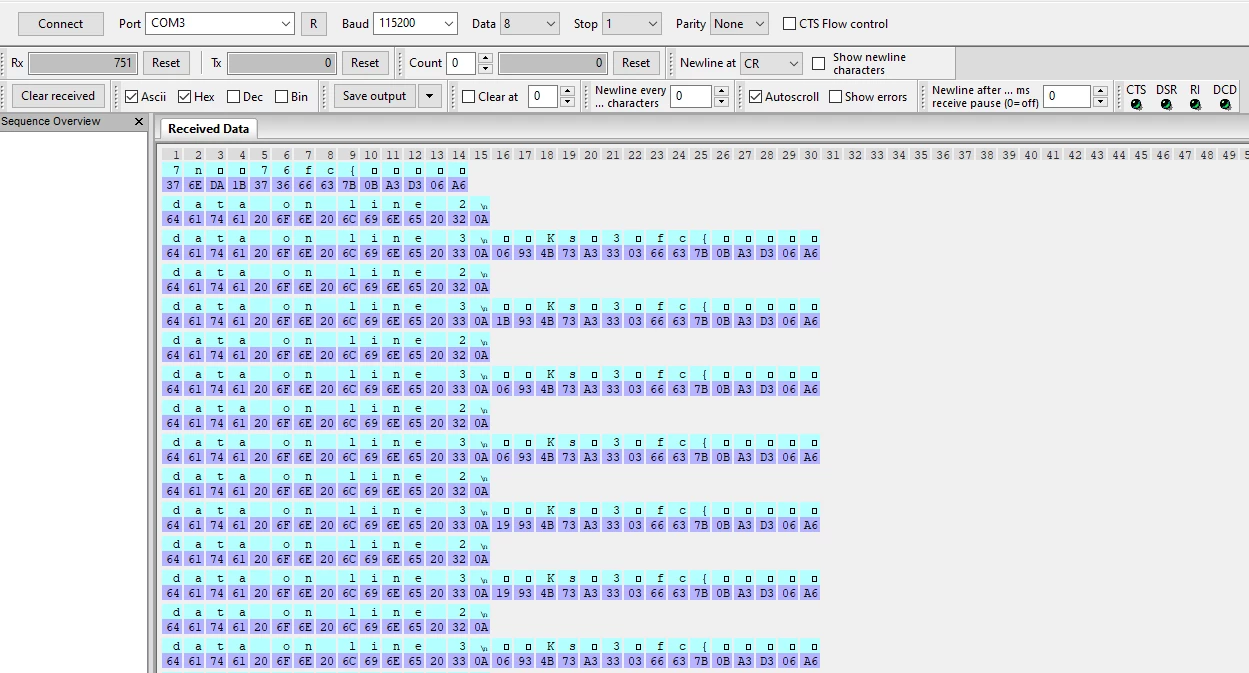

You are right USB to RS232 converter was the issue.
Changed it with FTDI FT232RL.
Now issue is little different as you can see below
and also like below:
Please check
waclawek.jan
November 22, 2019
I honestly don't know. At this stage, you might really need an oscilloscope or maybe even better a logic analyzer and look at the actual Tx signal.
