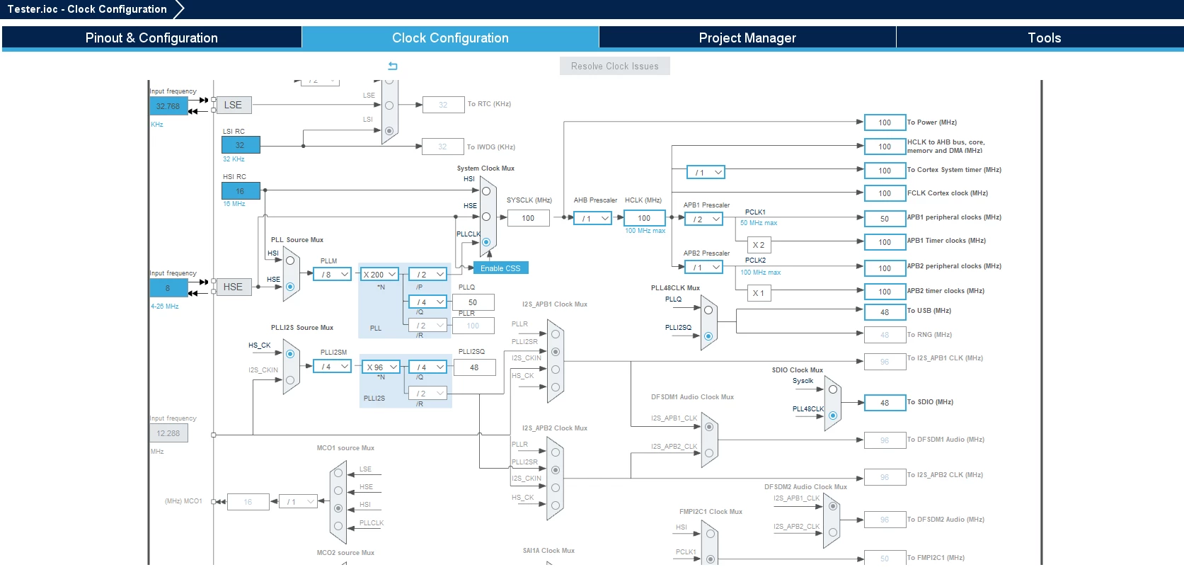

STM32F413 USB oscillator error when USB enabled
Hi All,

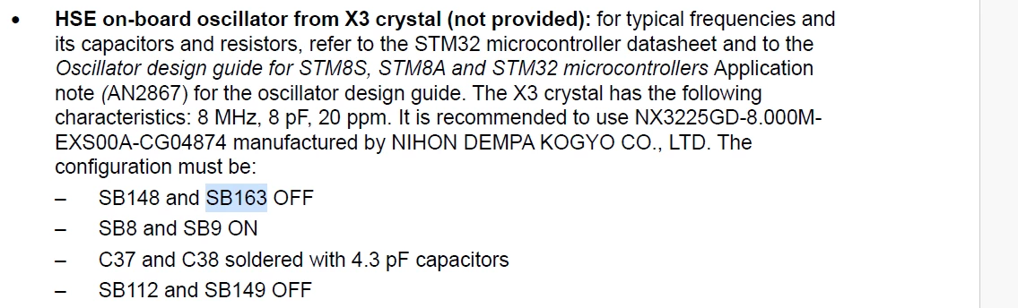

I have added recommended oscillator to a Nucleo - F413 board and made it to work on external oscillator by doing the recommended mods.
When, I Initialised the clock for USB, with the settings below, then HAL_RCC_OscConfig returns a timeout as HSE is never ready.
/* Wait till HSE is ready */
while (__HAL_RCC_GET_FLAG(RCC_FLAG_HSERDY) == RESET)
if ((HAL_GetTick() - tickstart) > HSE_TIMEOUT_VALUE)
return HAL_TIMEOUT;
Could someone please give me some insights into the problems.
What oscillator?
What mods? How did you do them? Can you post a photo?

As per the Nucleo user manual, I made the modifications. The oscillator is a 8MHz connected to microcontroller.
waclawek.jan
Dec 3, 2024 5:50 PM UTC
That looks OK.
You have not set HSE BYPASS, have you? I don't know how is it set in CubeMX, I don't use CubeMX.
