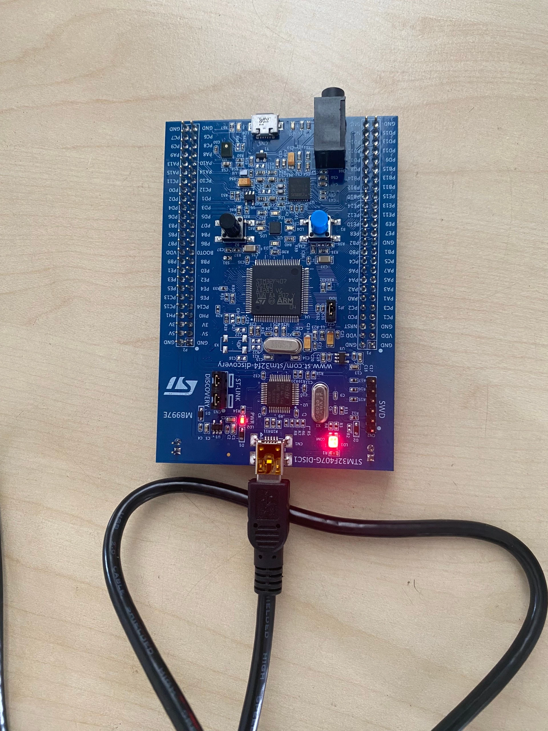

STM32F407G-DISC1 unable to be found on STMCube IDE
Hi, I'm having trouble when debugging the STM32 project. The board was connected to my laptop, however, on the IDE I can not find the option to debug on the target board.
I bought this board a month ago and debugged it only a few times before.
Please help me to solve this problem, thank you very much.

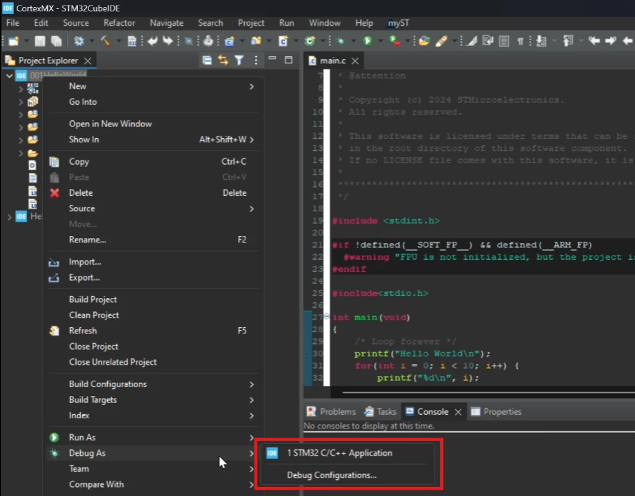

Hello @Nhat and welcome to the community,
I apologize for my late reply.
Could you please click on "Debug Configuration"-> "Debugger" tab,  and click on ST-LINK S/N and scan as shown in the below figures.
Could you please try with another cable?
I hope this help you!
Thank you.
