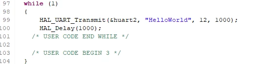

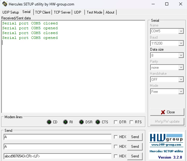

i am trying to use the esp322's TX and RX pins to transmit a string from the STM32F407 and display it to the Hercules. The problem I still have is that it cannot send even though I have selected the correct COM port and Baud-rate

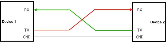

    1. The diagram does not show where/how the hercules is connected.
    2. In the code snippet, line 99: 12 is the number of characters to send. but it is invalid. Likely you've forgotten \r\n.
    May 30, 2024
    I added \n but still not sending

    Check signals with a scope or logic analyzer
    Make sure HSE_VALUE reflects that of your board, so the baud rates of the two MCU match.
