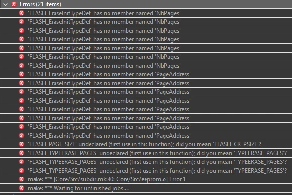

Hello @omeraydin,
Perhaps you are using different implementation of xx_hal_flash.h file maybe for a different product. You need to pay attention to the driver being used.

please check the library used for eeprom and your function implemention.
may be your "NbPages" or "PageAddress" should be "NbSectors"/"Sectors".
Do check your flashstruct
