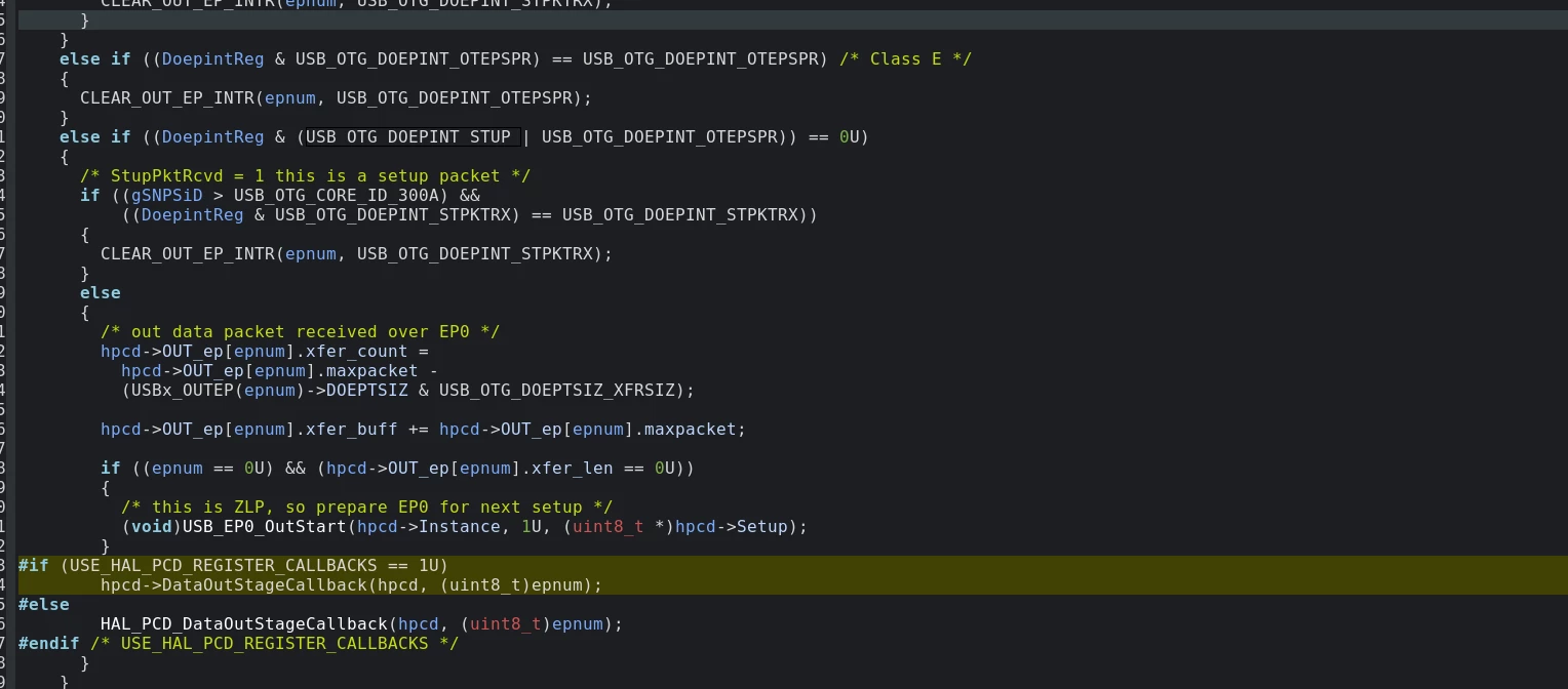

The only point I could find where USB_OTG_DOEPINT_STUP is used is in
stm32f4xx_hal_pcd.c. void HAL_PCD_IRQHandler(PCD_HandleTypeDef *hpcd).
line 1125: if ((epint & USB_OTG_DOEPINT_STUP) == USB_OTG_DOEPINT_STUP)
Is that the right point ot start? When i trace the called from there it does not end up to USBD_LL_SetupStage. Trying to find out att what point the code filters out interface from the device decscriptor requests.
​Probably.
And where does it end up?
Also, from where is ​USBD_LL_SetupStage() called? Textual search the sources (and Cube *is* *your* sources now).

[1] And where does it end up?
USB_OTG_DOEPINT_STUP only used i stmf4xxx_hal_pcd.c
code:
0693W00000SttrqQAB.pngeither ends up in:
a CLEAR_OUT_EP_INTR(epnum, USB_OTG_DOEPINT_STPKTRX); for SETUP packet
clears out flags
d (USBx_OUTEP(epnum)->DOEPTSIZ & USB_OTG_DOEPTSIZ_XFRSIZ); for EO packet
clears out flags
c. (void)USB_EP0_OutStart(hpcd->Instance, 1U, (uint8_t *)hpcd->Setup); for ZLP
stm32Fxx_ll_usb, sets some flags
d. HAL_PCD_DataOutStageCallback(hpcd, (uint8_t)epnum);
 UNUSED(hpcd);
 UNUSED(epnum);
[2] Also, from where is ​USBD_LL_SetupStage() called? Textual search the sources (and Cube *is* *your* sources now).
That is exactly the answer I was looking for, : -)
Did that text search and failed to find anything. that why posting this, being stuck here and looking for clues...
