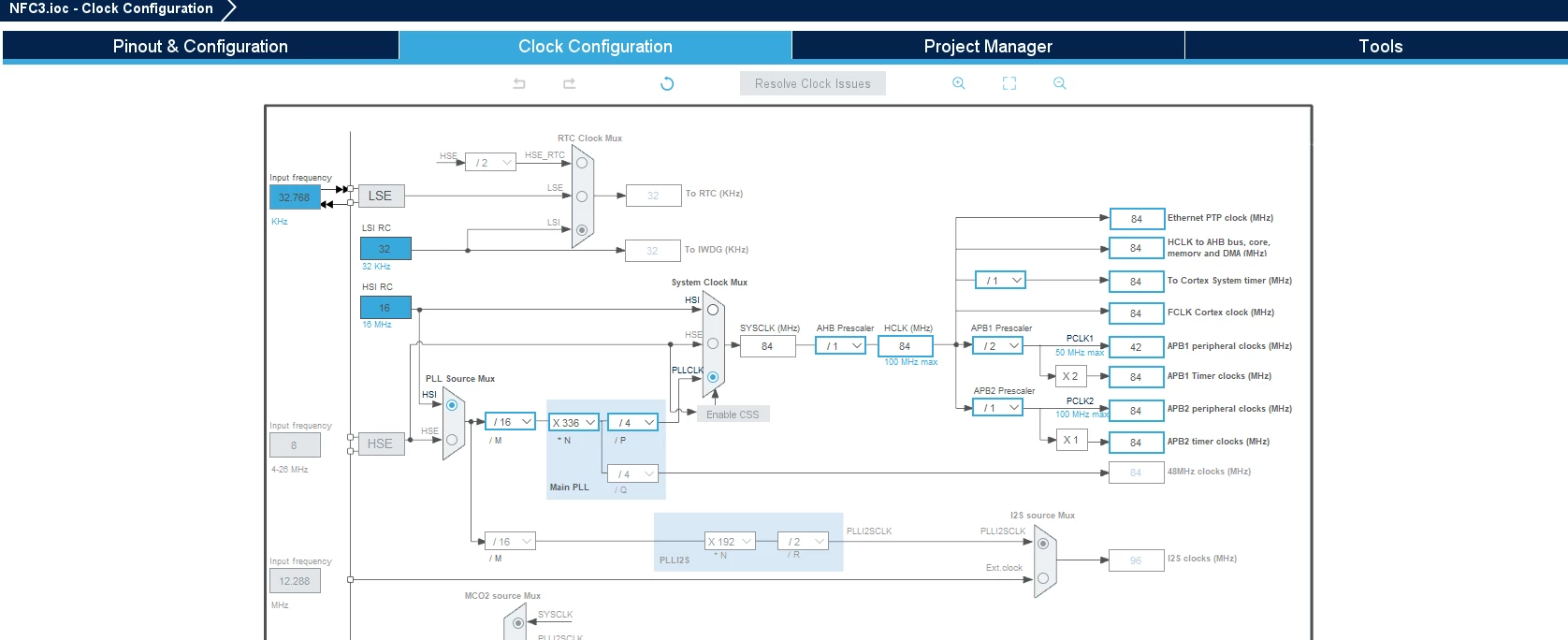

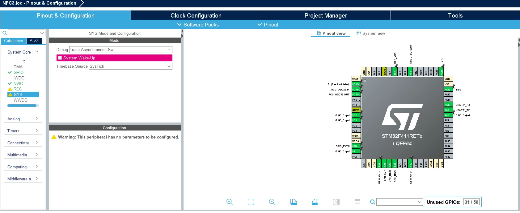

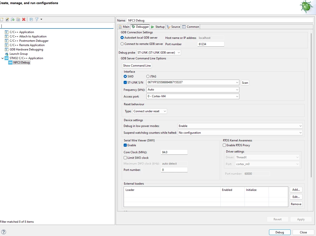

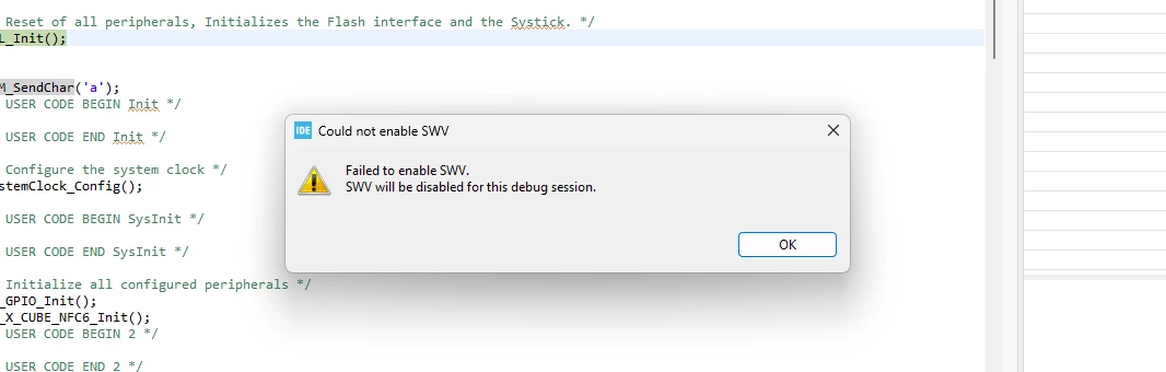

I am using the Nucleo-STM32F411RE development board, I have enabled SWV and configured it as per the instructions. But, Getting error saying below.
Failed to Enable SWV.
SWV will be disabled for this debug session.
I am not sure, What is missing. I have followed all the instructions mentioned.
Please find the attached detailed configuration and error message snapshots.

Hello @Akash_M;
I recommend you to take a look at UM2609 and precisely section 3.2 Debug with Serial Wire Viewer tracing (SWV). This section can help you to check all SWV debug configuration steps.
Also, I advise you to check the Nucleo-F411RE jumpers. For that please take a look at  STM32 Nucleo-64 boards (MB1136) - UM1724.
I hope this help you.
