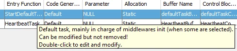

Additionally, it appears an additional "Default Task" is needed by the middleware abstraction, which seems problematic since it's adding an additional task to the scheduler that was not in the old project.  It's not very clear from the description in the configurator (below) when this task is actually needed; can it be safely removed if the middleware abstraction is not used?
Extra task means extra memory for its stack and more overhead. Again if there's enough memory, just accept it, get your project running, optimize later.  But note that some things should be initialized in context of a task rather than before the RTOS starts, mainly because of interrupt handling in the RTOS. Probably you already know about this.
Do not take the Cube generator too seriously, it is only crutches to help you start. Later you push it away and move by yourself. Good luck.
