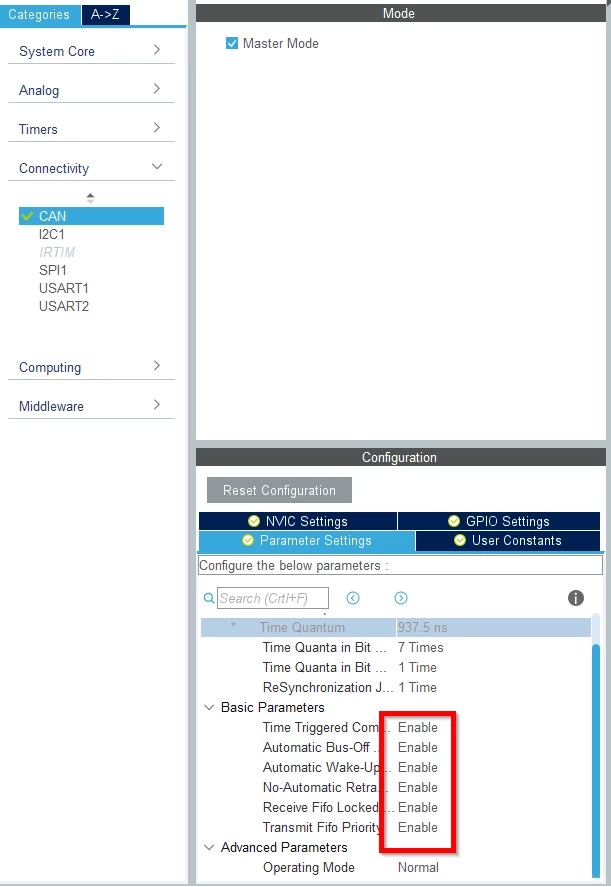

Hi there,
we are using the STM32F303K8 with the NUCLEO-F303K8 board. I installed the latest STM32 Cube IDE v.1.0.0 and wanted to get the CAN bus working.
So after searching for the latest documentation it took a while to figure out the new can bus implenentation. So as mentioned in "STM32L$ CAN new API and migration.pdf" my code looks like this:

In my opinion everything should be configured fine, so by running the main nothing happens on the pins using my oscilloscope:
PA11 -> D10
PA12 -> D2
Did I miss something to configure?

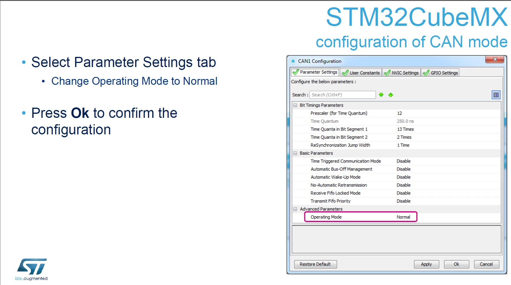

EDIT:
Seems to be an IDE problem: @ CAN CONFIG, IT SEEMS "ENABLE" in in reality "DISABLE" so inverted?!
Ok got it. Seems something with your introduction PDF is wrong:
After ENABLING the red marked CAN Config, the CAN BUS starts working as expected with your example:
