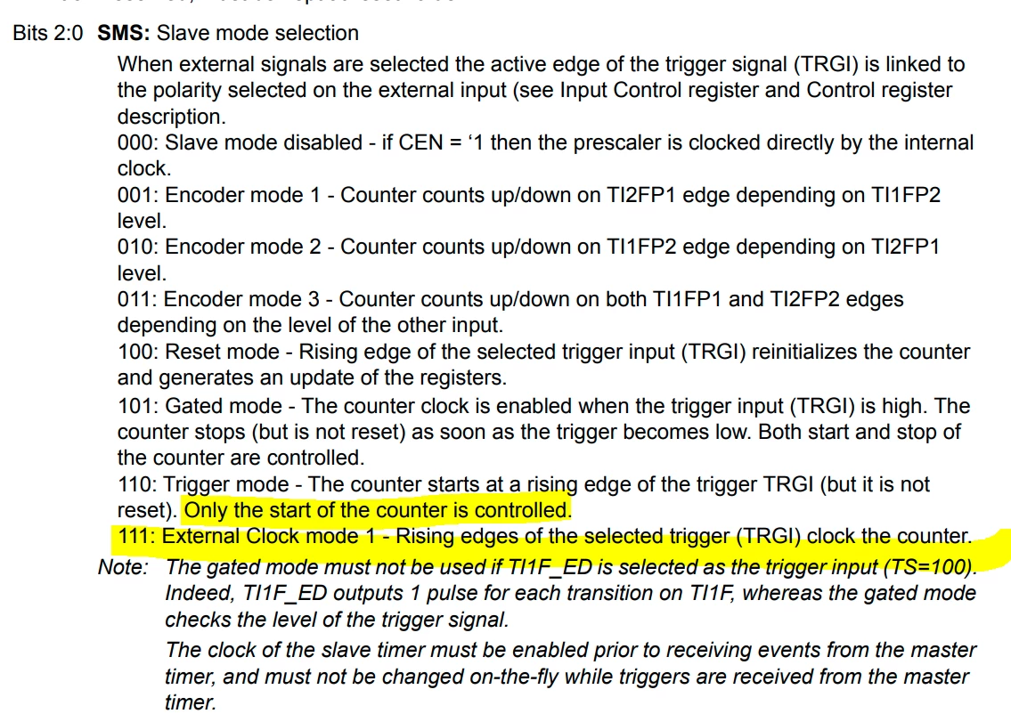

(STM32F105C8, STM32CubeIDE 1.9.0, MacOS 11.6.5) Using STM32CubeIDE, how do I can't get TIM3 to tick/count when TIM2 overflows. (TIM2 does count up)
TIM2:
Clock source: Internal
Master/Slave Mode: Disabled (Trigger input not delayed)
Trigger Event Selection: Update Event
TIM3:
Slave Mode: Trigger Mode
Trigger Source: ITR1
TIM2 counts up like it should, but TIM3 doesn't count the over flow, but has increasing numbers that don't make sense.
What am I doing wrong?
All the example I could find don't use the IDE/MX and I couldn't figure out how to map the registers to the HAL names.
Thanks in advance!

You want external clock mode 1, not trigger mode.
See "Using one timer as prescaler for another timer" in the reference manual.

Thank you, THANK YOU!!!
I was thinking external clock on a pin, not external to the timer, but internal to the F105.
