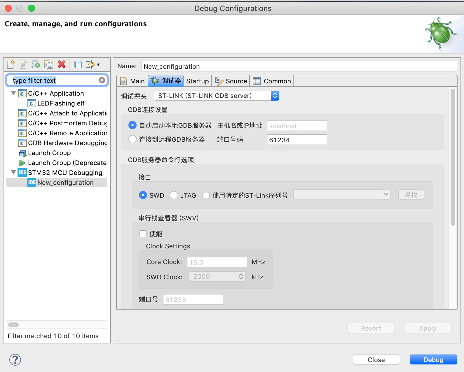

STM32F103ZET error: No device found on target.
After I click DEBUG ,it shows that
Error in initializing ST-LINK device.
Reason: No device found on target.
I think it's not hardware's problem because I can download my program in Keil uvision successfully. and my debug configuration is showed as follows:
0690X000008BZDuQAO.png0690X000008BZDzQAO.png​

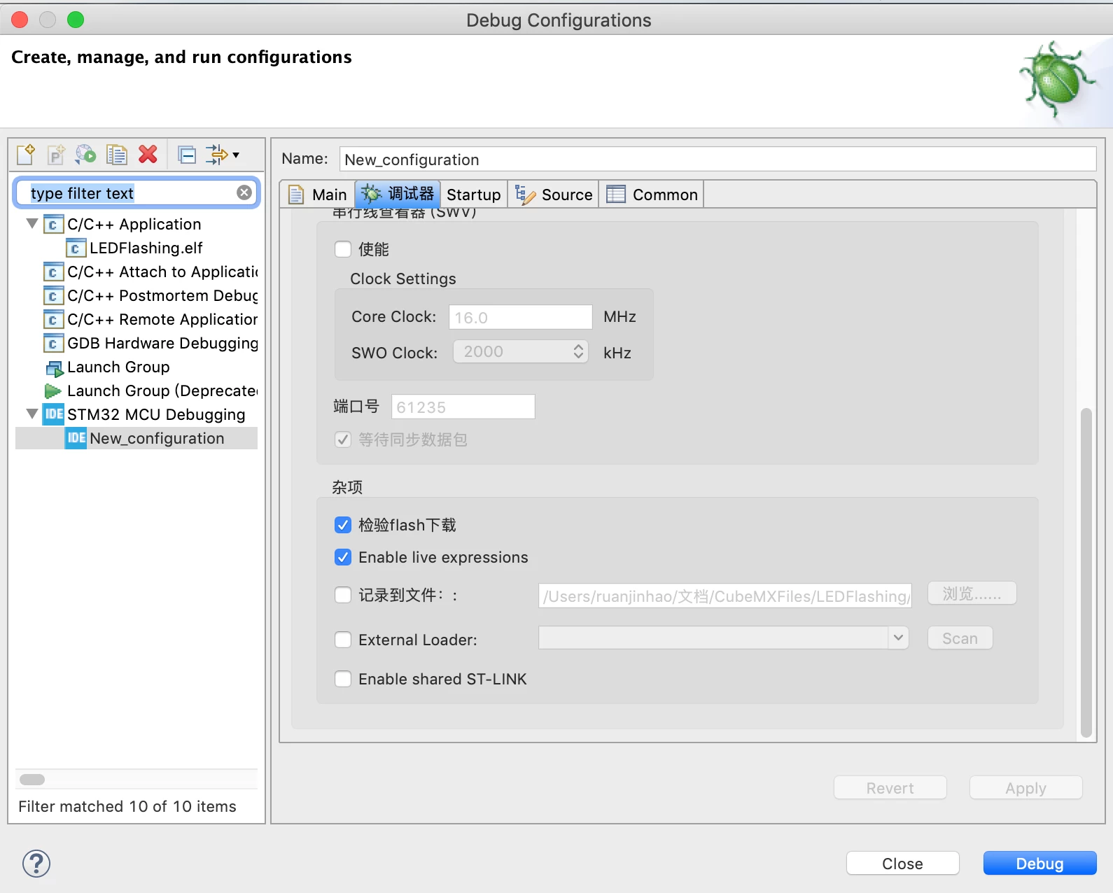

Under the "Enable live expressions" there's a box where you can enable a log. Can you activate that one, make a new try to debug and then send me the log?
RRuan
RRuanAuthor
May 14, 2019
I activated it, and this is the contents of the file “st-link_gdbserver_log.txt�?

Markus GIRDLAND
May 14, 2019
How is your workspace and installation set up?
I noticed the log gets logged to "文档/CubeMXFiles/TEST/Debug/st-link_gdbserver_log.txt" and any non-ascii characters in workspace path, installation path, project name or workspace name can give bad results.
