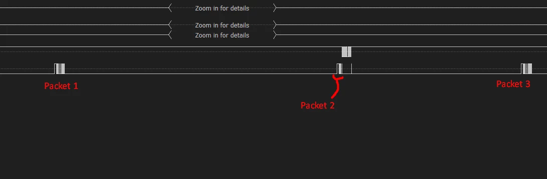

HAL_UARTEx_ReceiveToIdle_IT(): Issue
Baudrate: 9600
Reception interval: ~200 ms
The most common amount of bytes to receive is 8 (one packet). The RxEventCallback function is called at the start of the next packet.
Packet 1 is sent -> 200ms of nothing -> Packet 2 is sent -> RxEventCallback is immediately called with the reception size being 9-bytes. All data is correct and no errors are thrown.

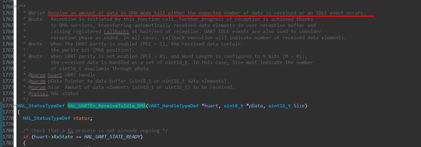

That doesn't go very well with DMA, which has to be configured to a byte count.
The documentation states that the DMA will stop when all bytes are received or when an IDLE event occurs.
I just set the "expected bytes" to the size of the buffer and parse all the data in the IDLE event callback.
I never used the "idle" feature of this UART.
Are you sure you configured it correctly ? I wouldn't trust Cube and the examples coming with it in this regard.
