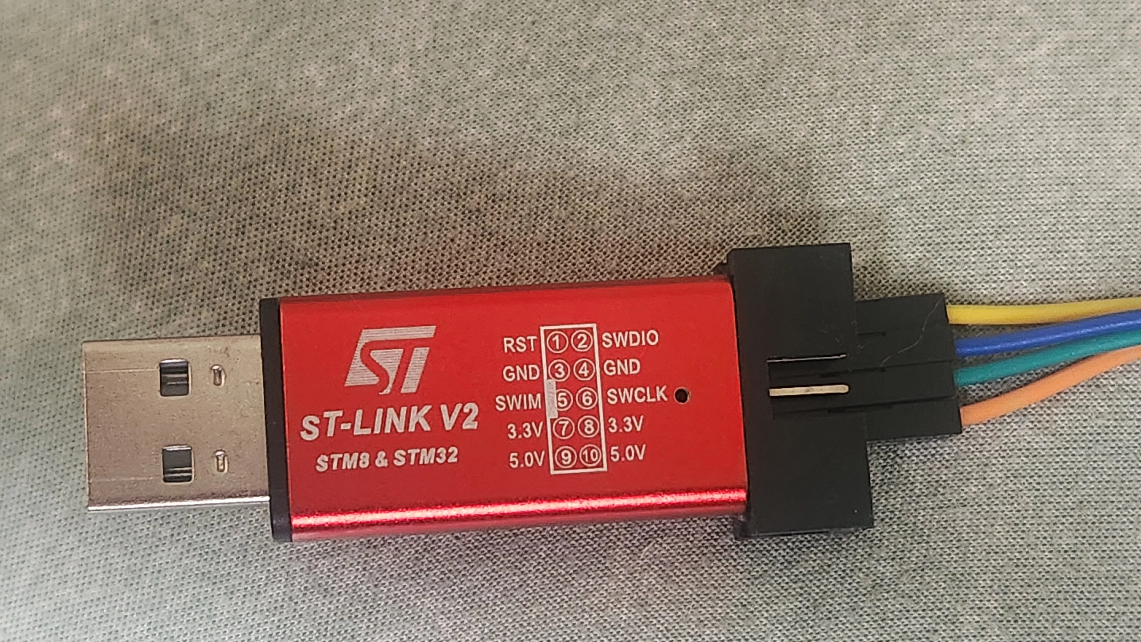

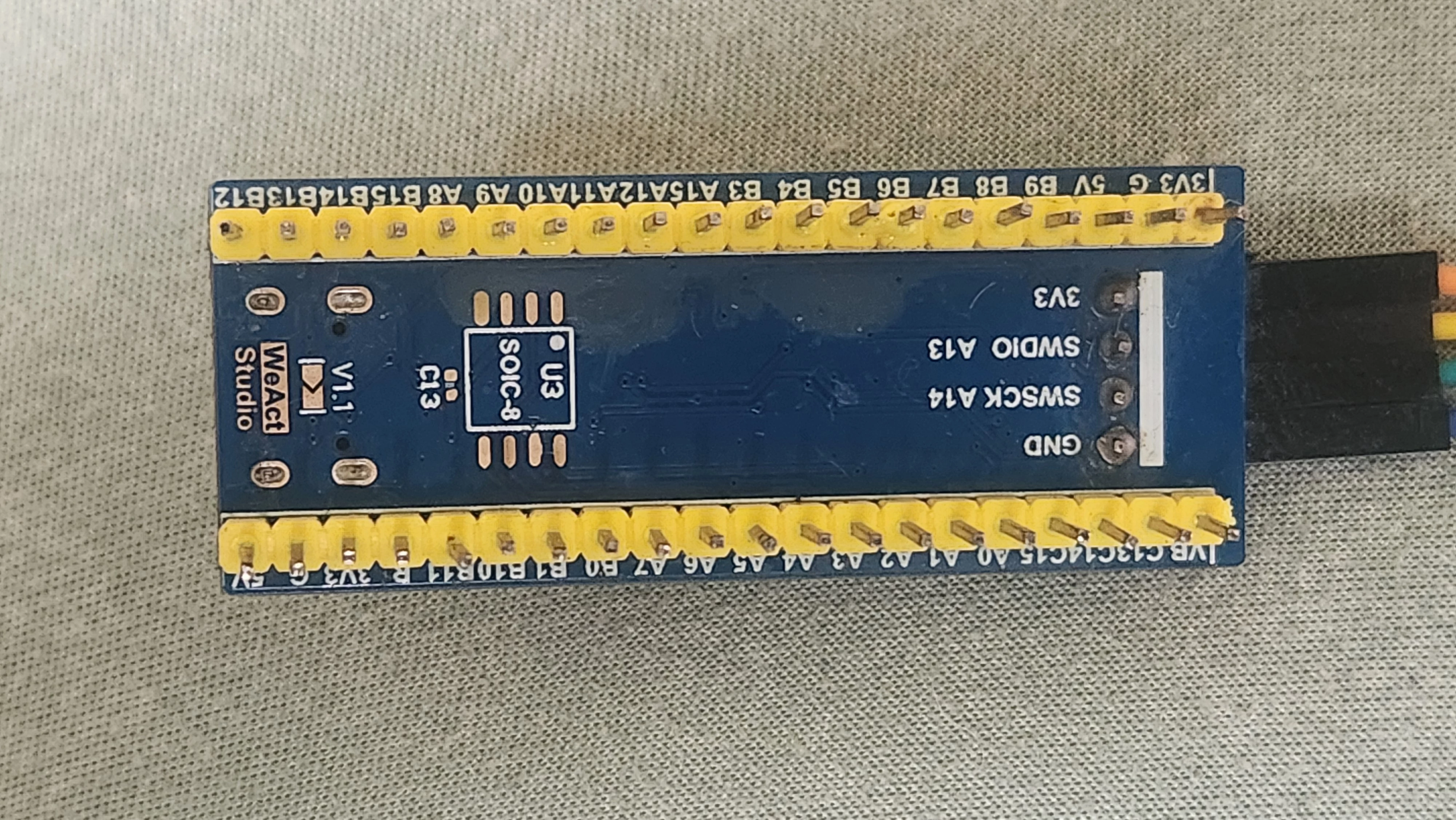

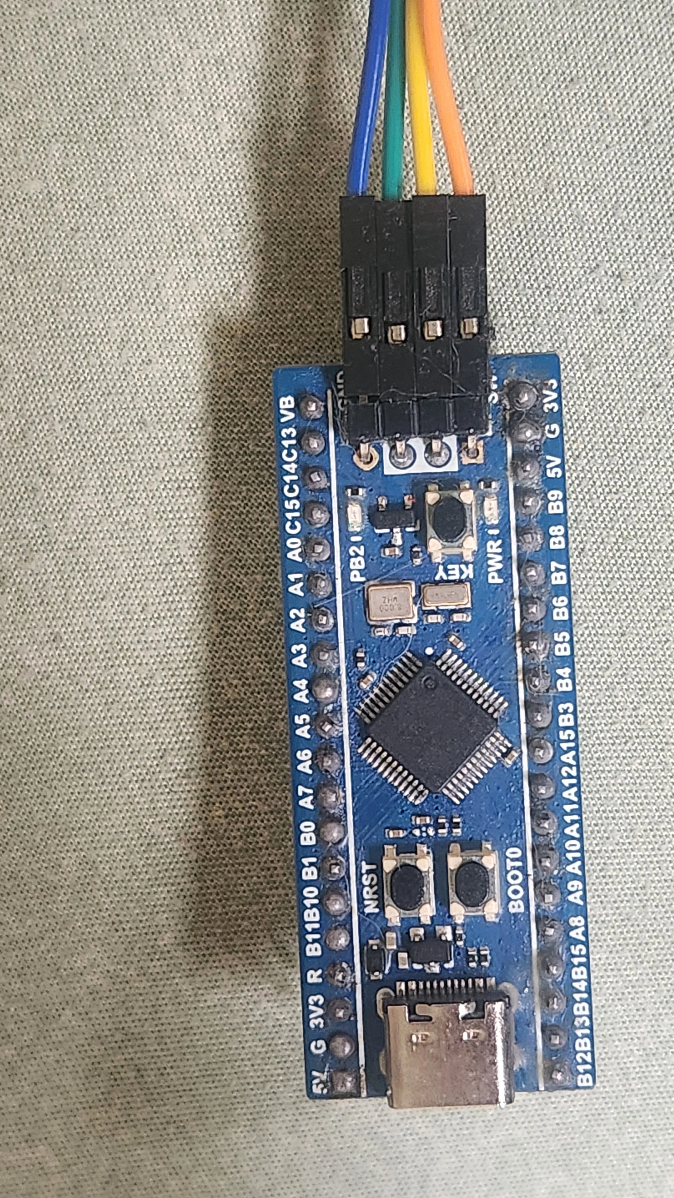

VK4KYTAuthor
Jan 2, 2025 3:17 AM UTC
here are the pics of the setup ... the st-link looks authentic, but now, I'm so sure about the chip itself.  Although I've been led to believe that the WeAct Studio product is good.
