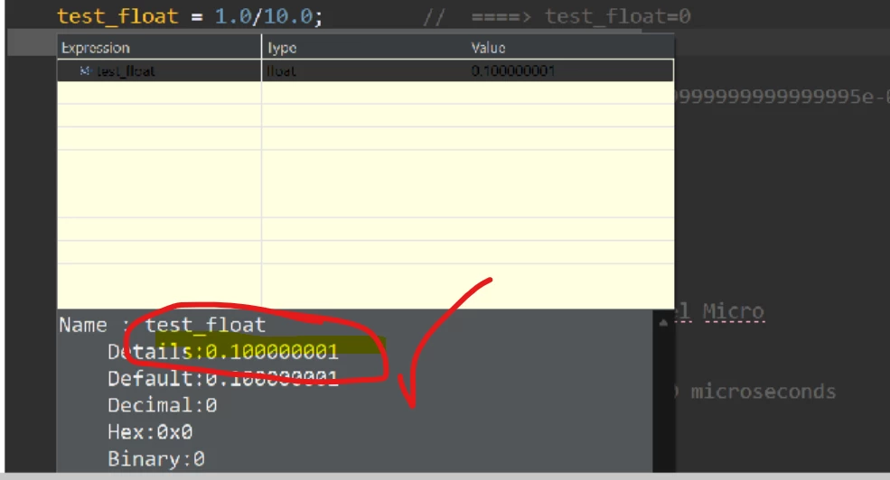

Hello STM32 Community.
I need your support, I am trying to do a small project where I need to use for example a var where PWM frequency is saved, as I need to calculate the period I just write a division 1/test_float and the result must be the period.... but the result is zero...
I am using a Blue pill board, STM32F103 and STM32Cube IDE.
I run this small example in order to show you my issue.
float test_float =0;
test_float = 1/10;    // ====> test_float=0
test_float = 1/1000;   // ====> test_float=0
test_float = 1/10000000; // ====> test_float=0
test_float = 0.0000001;  // ====> test_float= 9.9999999999999995e-008  that is OK
Why first four lines are equal to zero?, last line (test_float = 0.0000001; ) it has the right value ...100 ns
any comment/advice is welcome
regards
Alfredo
Tesla DeLorean
Tesla DeLoreanBest answer
Guru
May 26, 2022
Write as
test_float = 1.0/10.0;
or
test_float = 1.0f / 10.0f;
So it knows the constants aren't integers, which the C compiler will assume they are otherwise.

Hi Tesla DeLorean, thanks a lot for your comment!!!!
You are right, after adding ".0" it´s works.
Thanks!!!! Again
Alfredo
Andrew Neil
May 27, 2022
@ERABALF​ - Note that this is standard C stuff - nothing specifically to do with STM32F103.
