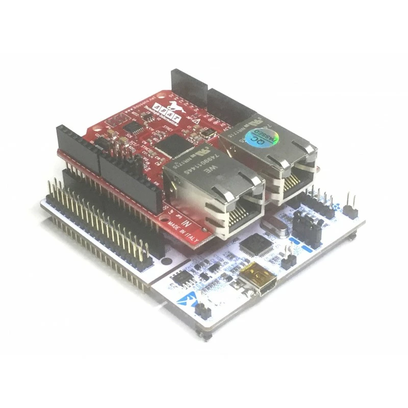

Hello~
I am testing my stm32f103rb board with ethercat board(as shown). The trouble i am having is that there is no easycat library to use. I did some research and only found the .cpp easycat library. I'm using stm32ide and written in C language. This is causing me problems. Is there a header .h and source .c library file for easycat? Please help me.

    This: https://www.bausano.net/shop/en/home/1-arduino-ethercat.html ?
    STM32CubeIDE supports C++, and it's possible to have mixed C and C++ projects ...
    As @mƎALLEm said, have you contacted the supplier for help with this?
    They seem targetted at Arduino - there are Arduino cores for STM32:
    https://community.st.com/t5/stm32cubeide-mcus/library-and-example-experience-comparible-to-the-arduino-ide/m-p/658827/highlight/true#M26010

    You may contact the shield manufacturer as he may provide libraries/demos:
    https://www.bausano.net/en/hardware/easycat.html
    Libraries for Arduino are available at the same page:
