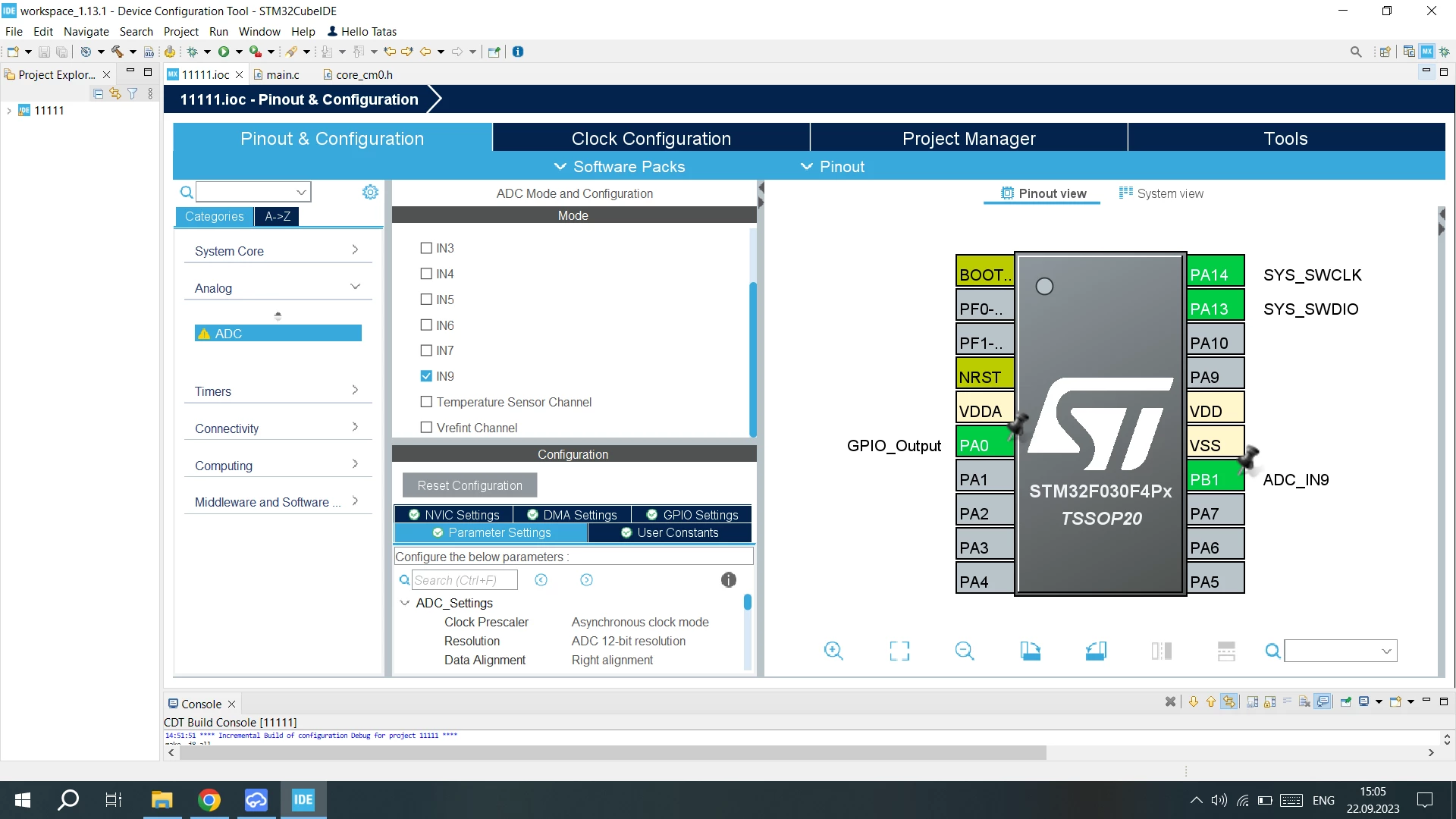

Hello. I am new to STM32F030F4P6TR programming, so I am asking for your help. You need to write a simple program to light up the LEDs depending on the voltage.
But I have some problems with the ADC. To begin with, I wrote a simple program that flashes the LED and everything worked. After that, I turned on the ADC on the PB1 port in the cube. The program is downloaded to the microcontroller. But it was not executing and the LED was not blinking. I tried to check through the debugger and I got this while executing SystemClock_Config(); Microcontroller overloaded.

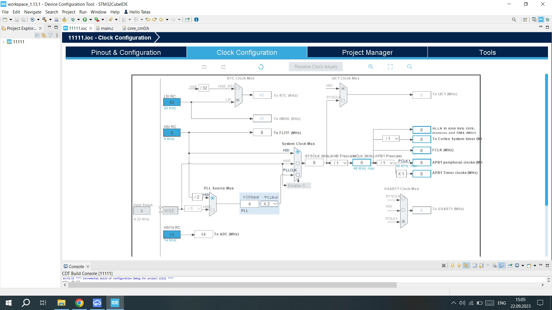

I am very grateful to you. But I think the problem is in CubeMX. When I select and enable ADC in it. CubeMX generates files incorrectly, and the microcontroller hangs at startup. I watched a lot of videos on how to properly work with ADC, but I can't get anything with STM32F030F4P6TR. Maybe it's better to write to CubeMX support, or maybe I'm doing something wrong.

Thank you . but i think i found the problem. I did not connect VDDA to 3.3 V. Tomorrow I will try to connect everything and try again, I will write about the result
