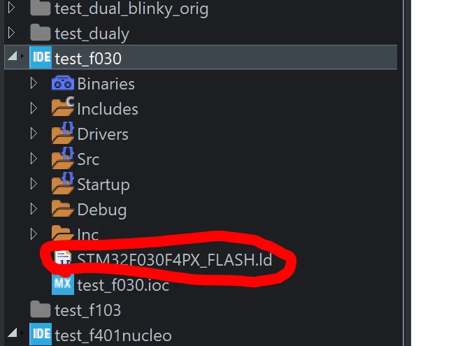

The project was created, but when I compile, all the data by default is mapped to address 0x00008000, just after the valid range of the flash mirror. How strange...
Problem one: The file STM32F030F3Px_FLASH.ld was never created in my project, so I found one online and put it into my project folder
Problem two: The linker argument builder is not able to resolve the ${workspace_loc:/${ProjName}/STM32F030F4PX_FLASH.ld} path, so no -T "c:\foo\bar\STM32F030F4PX_FLASH.ld" is added to the linker command-line.
Work-around for problem two:
Added under other flags for the linker: -T "${workspace_loc:/${ProjName}/STM32F030F4PX_FLASH.ld}" - The quatation marks are important, else \ for windows paths turns into escape characters...

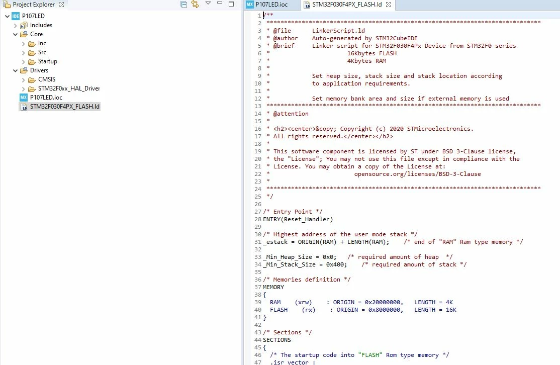

I just tried this. Linker file is generated just fine. Same OS and software versions as you (but English locale).
Are you selecting STM32CubeIDE as the Toolchain/IDE? Share your IOC file.

I agree linker file is part any project generation whatever from STM32CubeIDE or STM32CubeMX.
Root issue is at project generation ... @Community member​ please could you share more details about your project creation way of working ?

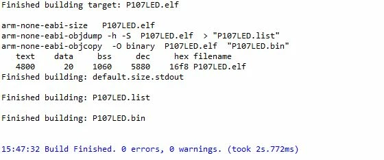

Compiled project could not be loaded into STM32 MCU using any of the adapter settings (using a STM32-devel kit as SWD bridge to my actual board).
After some studying of the result .ELF file with arm-none-eabi-objdump, I saw that the entire .code and .data sections were mapped into 0x8000.
Then I noticed that there was no linker script in the project folder, so I added that manually
But it still was not used, no -T argument used for linking, so added the -T argument manually, and finally I had a working binary that does give assertions in openOCD or disconnect errors with STLINK tools.

Got linker file without issue from your .ioc file (IDE 1.3.1)
I've done my trial based on File > New > STM32 project from .ioc file
Project compiles without any issue
