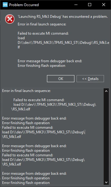

I'm not understanding why ( that why I'm here ...cpt obvious speaking) since 2 days I can't flash or debug under CubeIDE while in the same time connection and flash is working perfectly
for the record I'm working on a stm32WB35 using a stlink V3 v
STM32CubeIDE is : 1.15.1
STM32CubeProgrammer is 2.14.0

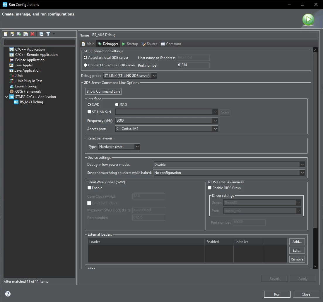

I've slow down the speed and tried all reset modes
when I'm flashing under CubeIDE I have this results
STMicroelectronics ST-LINK GDB server. Version 7.7.0
Copyright (c) 2024, STMicroelectronics. All rights reserved.
Starting server with the following options:
 Persistent Mode : Disabled
 Logging Level : 1
 Listen Port Number : 61234
 Status Refresh Delay : 15s
 Verbose Mode : Disabled
 SWD Debug : Enabled
ST-LINK device status: UNKNOWN
Waiting for debugger connection...
Debugger connected
Debugger connected
 STM32CubeProgrammer v2.16.0
Log output file: C:\Users\O08A6~1.GAS\AppData\Local\Temp\STM32CubeProgrammer_a17572.log
ST-LINK SN : 002C00363331510F34333834
ST-LINK FW : V3J15M6B5S1
Board : STLINK-V3SET
Voltage : 2.92V
Error: No STM32 target found! If your product embeds Debug Authentication, please perform a discovery using Debug Authentication
2nd connect tentative with frequency (8MHz)
Voltage : 2.92V
Encountered Error when opening C:\ST\STM32CubeIDE_1.13.2\STM32CubeIDE\plugins\com.st.stm32cube.ide.mcu.externaltools.cubeprogrammer.win32_2.1.201.202404072231\tools\bin\STM32_Programmer_CLI.exe
Error in STM32CubeProgrammer
Shutting down...
Exit.
