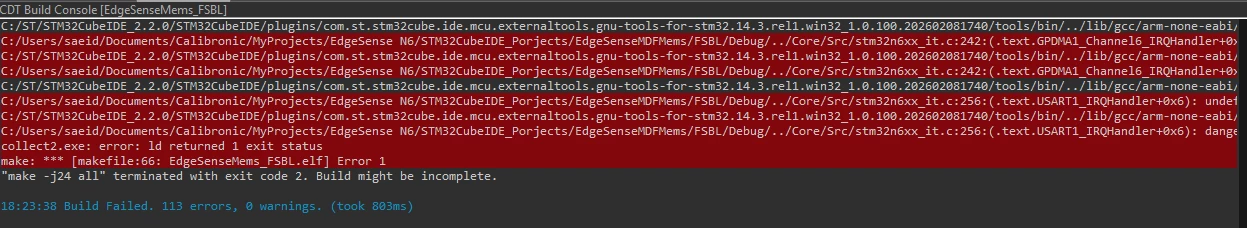

I’m working with an STM32N6 project and I am facing a build issue after generating a project with STM32CubeMX.
The project generates successfully and the driver folder is present, but when I open it in STM32CubeIDE and build, I get many linker errors related to missing HAL functions.
I checked the STM32N6xx  HAL driver folder, and I do not see the HAL source files
It looks like the generated CubeIDE project is not adding the HAL driver  files into the build.
My setup:
  • STM32CubeIDE: 2.2.0
  • STM32CubeMx: 6.18.0
Can you please advise if there is any additional setting required to avoid this issue ?  or if this is a CubeMX generation issue?

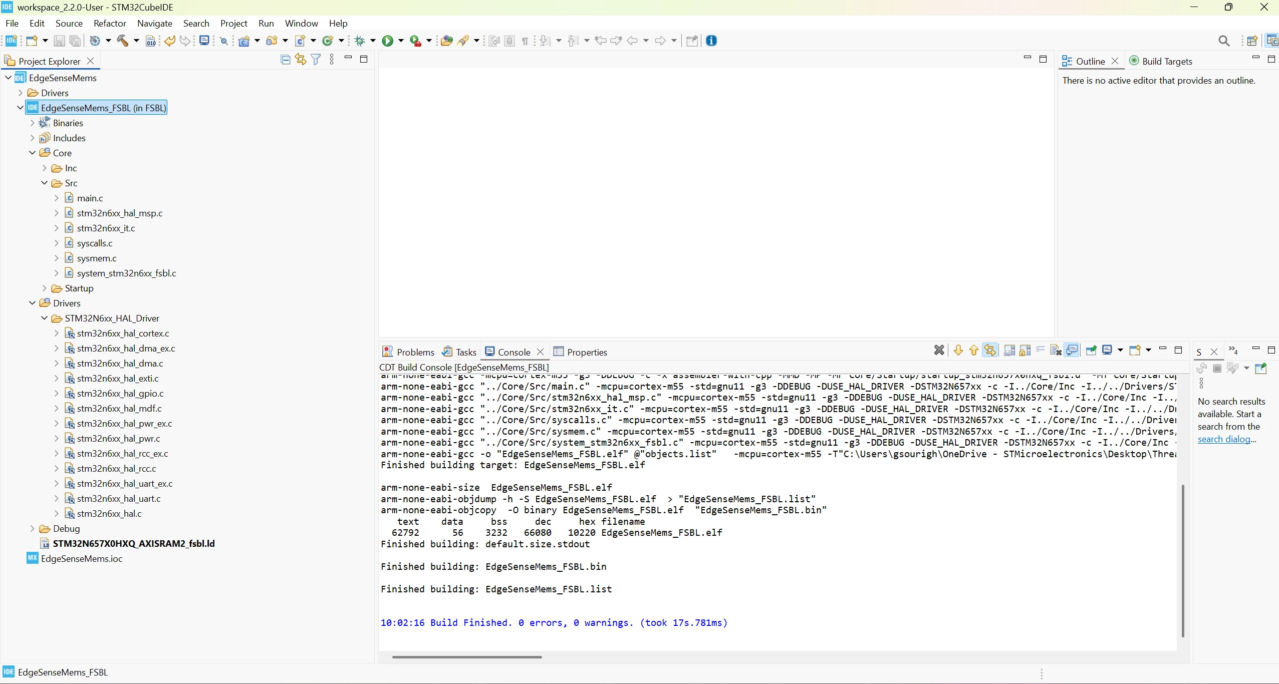

Aug 4, 2026 9:06 AM UTC
Hello ​@Saeid
I used your IOC to generate the code .  the build has been finished successfully as shown in the following screenshot
So let’s  copy the .ioc file alone into a new empty project folder , and regenerate the project in a new workspace.
THX
Ghofrane
