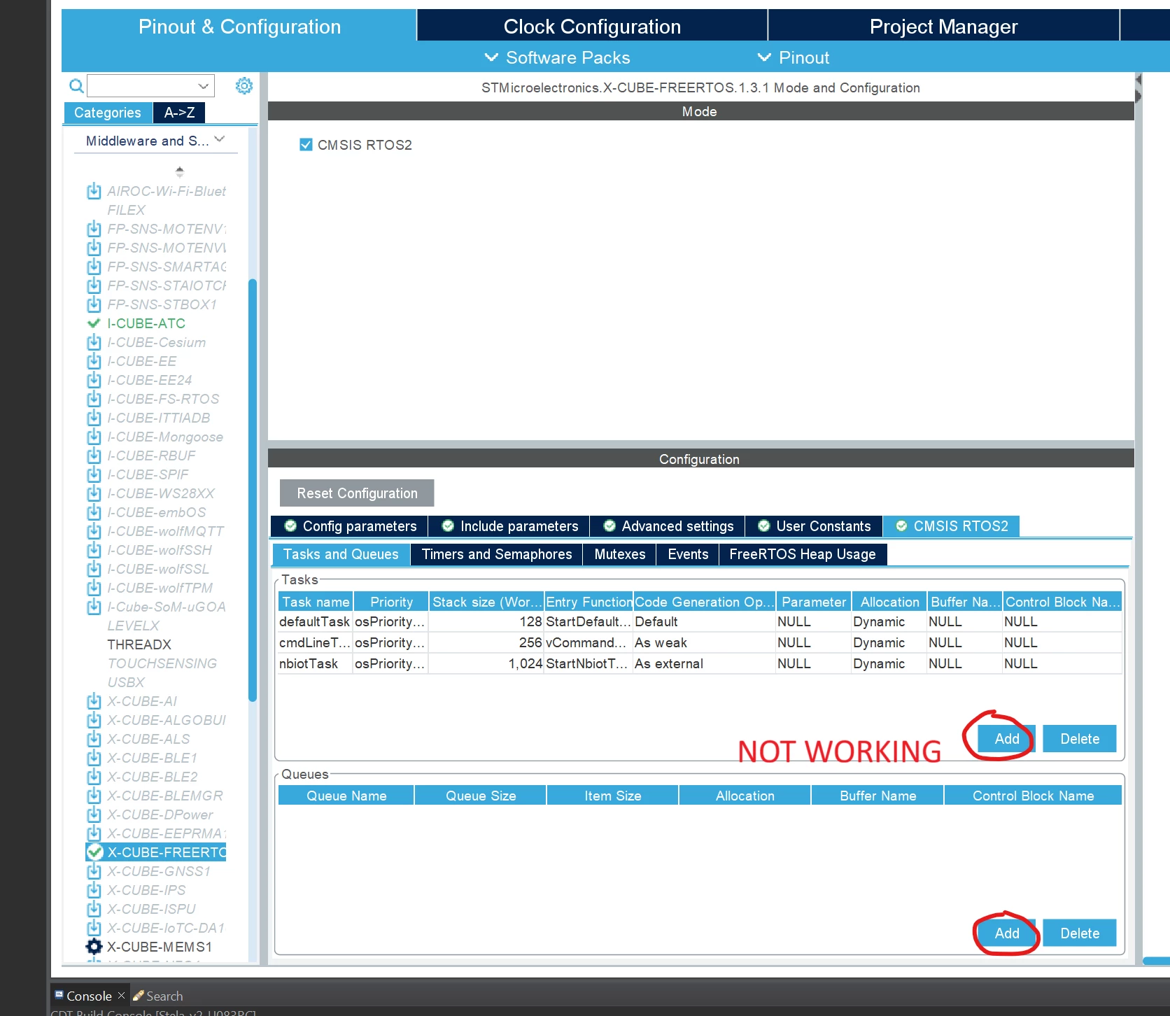

Periodically, the Add buttons in the configurator stop working and it is impossible to change values in tasks, queues, etc. The system does not respond to mouse clicks (the editor window does not appear). However, the Delete button works. Restarting the IDE helps. It works in other configurators (GPIO, NVIC, Definition Creation).

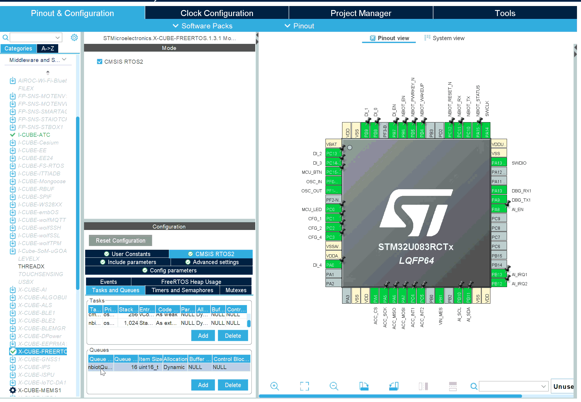

Hello @ATret.3 ,
I created a project from scratch with STM32U083RCTx, and the behavior described was not reproduced
with STM32CubeMX Standalone and MX integrated in IDE.

I only encounter this problem in STM32CubeIDE. It doesn't happen right away, but after 2-3 compilation/debugging cycles. Everything works fine in CubeMX. Now I've switched to working in parallel with a separate CubeMX for editing the ioc file and generating code, and CubeIDE for working with code and debugging.
I am not ready to provide my ioc file yet. I will try to make minimal builds and provide the file and results.
